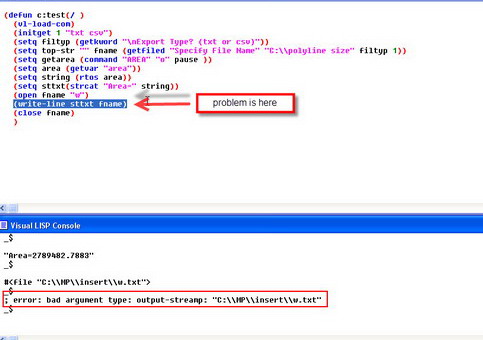

Hi all ,
I am having a problem when I try to create txt file like attachment
can anyone help.
thanks.
(defun c:test(/ )
 (vl-load-com)
 (initget 1 "txt csv")
 (setq filtyp (getkword "\nExport Type? (txt or csv)"))
 (setq top-str "" fname (getfiled "Specify File Name" "C:\\polyline size" filtyp 1))
 (setq getarea (command "AREA" "o" pause ))
 (setq area (getvar "area"))
 (setq string (rtos area))
 (setq sttxt(strcat "Area=" string))
 (open fname "w")
[color=red] (write-line sttxt fname)
[/color]   (close fname)
From memory, (on the phone), the file argument for both write-line and close is not the string of the file name and path, but rather the return from the open function. You need to capture the (open fname "w") into a variable and use that instead of fname.
To put in code Clint's observation:
[color=red](setq fileStream [/color](open fname "w")[color=red])[/color]
(write-line sttxt [color=#ff0000]fileStream[/color])
(close [color=#ff0000]fileStream[/color])

Thanks guys it work perfectly now.
Thanks a lot.
Thanks for the code Mircea. :-) I was struggling with the phone.
