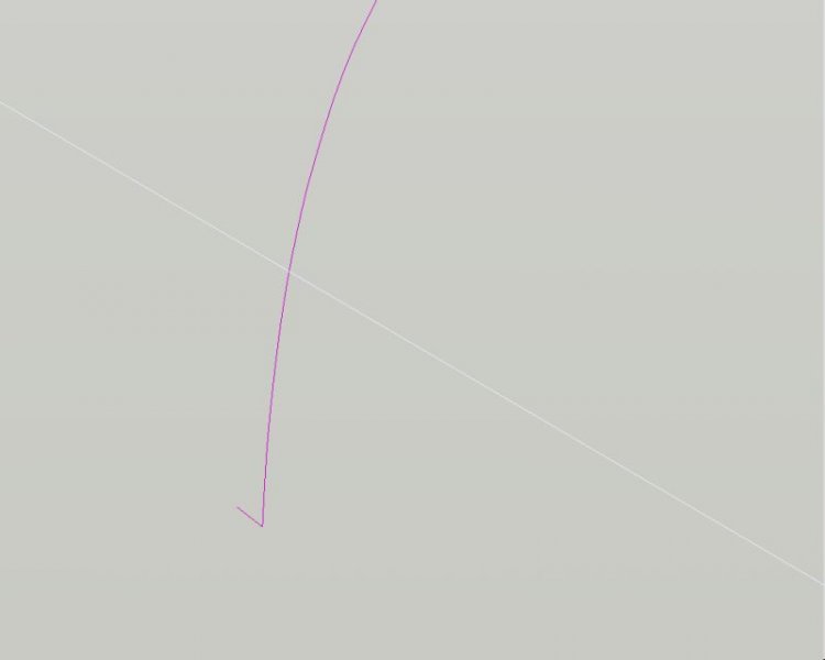

Hrcko Posted April 13, 2014 Posted April 13, 2014 Hi! I am working the drawing in the 3D environment. I want to put the point in the intersection between line and 3D Polyline. I can't find the intersection point with a mouse pointer and seed the point in the right place. Here is the picture of the two lines in question. Thank you for the help. Kind regards, Hrcko Quote
nestly Posted April 13, 2014 Posted April 13, 2014 Try using the Apparent Intersection OSnap. Tip: If the objects have different Z values, Apparent Intersection OSnap snap to the intersection point that coincides with whichever object that's selected first. Quote

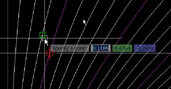

nestly Posted April 13, 2014 Posted April 13, 2014 Does this video show what you had in mind? If so, remember that Apparent Intersection is based on the current view, and as I previously stated, the intersection is calculated based on the Z value of the first object selected. Quote

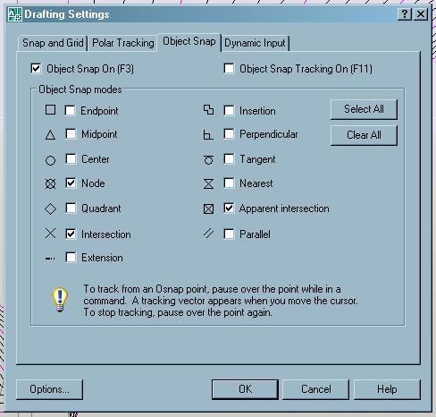

Hrcko Posted April 13, 2014 Author Posted April 13, 2014 Please, can you tell me what is checked in your settings? This is what I have: I have not yet results as you have in your demo video. Quote
nestly Posted April 13, 2014 Posted April 13, 2014 I was manually specifying the OSnap during the POINT command in the video, but to simplify things, try un-checking everything except Apparent Intersection. So I just tried it again and I think the problem may be the Perspective view causing the "Apparent" intersection to be misplaced. Try switching to Parallel perspective and see if you have better results. (PERSPECTIVE = 0 at the command line) Quote
Hrcko Posted April 13, 2014 Author Posted April 13, 2014 It is so inconvenient to be an novice in this matter. I can't obtain green mark to reference the line. There is no doubt, I am doing something wrong. Quote
nestly Posted April 13, 2014 Posted April 13, 2014 (edited) I may have given you some bad information. I don't think you can use a "running" Apparent Intersection OSNAP when the objects are non-coplanar because AutoCAD won't know which plane to snap to. Did you try specifying the Apparent Intersection OSnap while inside the POINT command, as shown in the video? If I may suggest an entirely different approach, perhaps you could copy your geometry to a blank area in your drawing, then use TRIM command to find the intersection of the line and the 3D polys. http://www.screencast.com/t/4NxrRZ7NfR Edited April 13, 2014 by nestly Quote
