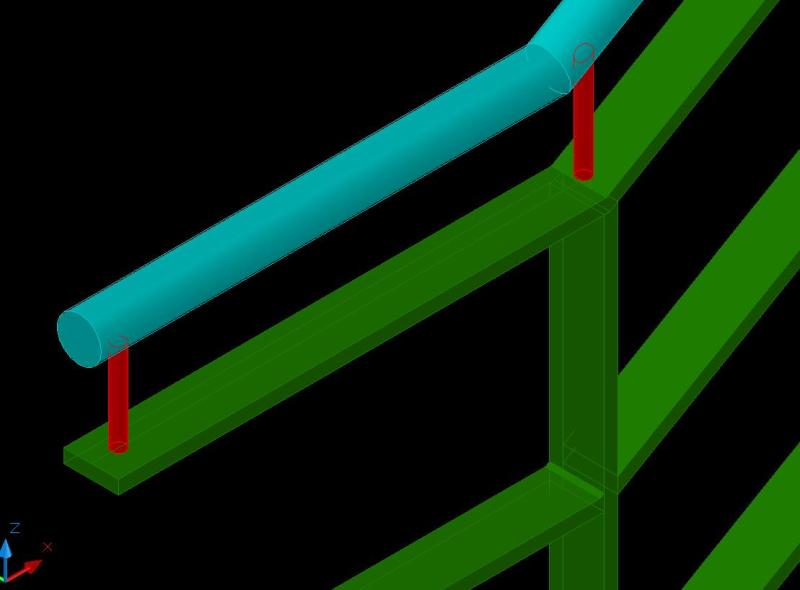

I am having problems with the edge lines of solids showing through but I can't see anywhere in the settings for visual styles why it should be doing it. see attached picture of my problem.

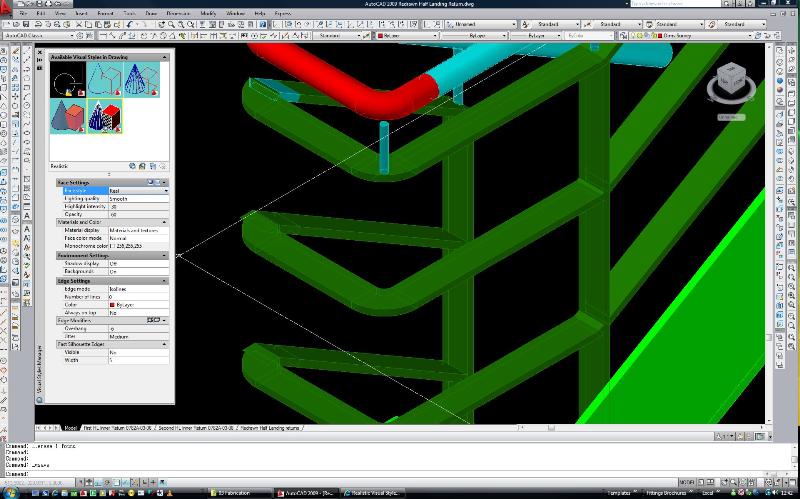

So you have checked Edge Settings, Edge Modifiers and Fast Silhouette Edges parameters under Visual Styles Manager and nothing appears to be ot of the ordinary?

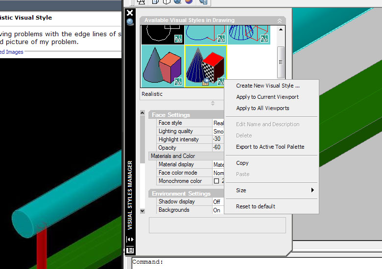

Your dwg was fine with my acad 2008/9!...I have to suggest to your realistic
style to reset default!You can right click on "realistic style" from visual style
manager dialog box!You can see my screen shot!
I did what you suggested but still the same problem. If I cut and paste the solid into a new template everything is fine but I can't for the life of me figure out why it is still like it.

Some drawings just seem to corrupt Autocads handling of Visual Styles so you get these Hidden lines show through.
I have two drawings open at the same time - one shows 3D hidden and Conceptual as correctly solid with no hidden lines showing through and the other shows all the hidden lines AND surface lines across each object plane. Yet when I started drawing this morning both drawings were fine, I have changed none of the settings - only jumped between different visual styles when suddenly this happens. I have purged, audited, restarted..

Best solution has been to go back to one your saved Views (not one of the autocad defaults) - somehow this seems to refresh Acads handling of Visual Styles back into a workable fashion. I dont know why this is tho. Any ideas?
Does this work for anyone else having this problem?
