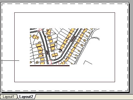

eldon Posted April 11, 2014 Posted April 11, 2014 That is really strange, because this is what I see with Layout2. Layout1 goes haywire with a custom scale of 0.8, but it is Portrait and you wanted Landscape. Quote

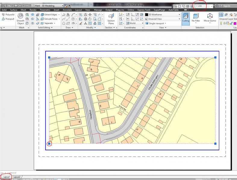

rkent Posted April 11, 2014 Posted April 11, 2014 You can't set the scale and see MS when you don't have the proper size viewport to begin with. An A4 is ~297X210mm so your viewport in PS should be something slightly smaller that that to start. Now apply the scale of 1000:1250 (or . as mentioned in an early post, this is because the drawing is in Meters and your PS is in mm. Take it from there. Quote
ReMark Posted April 11, 2014 Posted April 11, 2014 I think I have it. Note the viewport scale circled at the top. Note too that this is Layout1 and it is in landscape mode (A4 paper size). The viewport is on its own layer and assigned the color magenta. Did I achieve the desired results? How say ye? Yea or nay? Quote

mifty12 Posted April 11, 2014 Author Posted April 11, 2014 I hate to say it but it looks of a similar scale to those i have tried. Have you tried printing to see if it scales off the same as the model ? I really appreciate your efforts on this. Seems like a lot of work for something that should be fairly sime!! Quote
ReMark Posted April 11, 2014 Posted April 11, 2014 I did not print it because I work in imperial units and print to imperial sized paper but I have no doubt it will print correctly. Quote
mifty12 Posted April 11, 2014 Author Posted April 11, 2014 Would you be able to post it here so that I can take a look or would my personal settings affect the output ? Quote
ReMark Posted April 11, 2014 Posted April 11, 2014 Post what where? You mean attach a copy of the drawing? BTW....I did print it after all and it came out very well indeed. The fact that AutoCAD has the print area defined (dashed lines) at least meant it would fit on my 8.5x11 (inches) size paper. Quote
ReMark Posted April 11, 2014 Posted April 11, 2014 Here you go. Don't say a yank never done nothin' good for ya. Sorry, but I have to go now. I promised my wife I'd take her to dinner. rkent and eldon can answer any other questions you have. They know way more than I do about metric. Bye. 1;1250 Plot A4 ReMark.dwg Quote

mifty12 Posted April 11, 2014 Author Posted April 11, 2014 Just got home and have managed to take a look at the file. Unfortunately when i print it out it is still not to scale. If you look at the line under'El Sub Sta' it measures 22.063 on the model. When printed and scaled off the hard copy drawing it measures 32.330 approximately. Quote
eldon Posted April 11, 2014 Posted April 11, 2014 I am surprised that your problem is not yet solved. Did my pictures look anything like you would be expecting? The first one was done in model space without the aid of view ports. I take a slightly different route to a paper copy, in that I plot to a PDF, and then print with Adobe Acrobat with the page scaling set to natural size. Do you have a scale bar that you could add into the drawing to give a proper known line to measure? Quote
