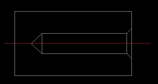

This lisp have some defects, Below:
And It's only support "Line" But I want support "Pline" .
Thanks you all for what ever advice or help you can spare.

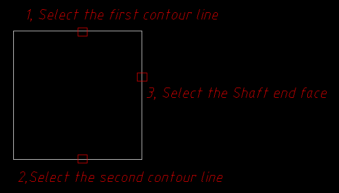

I think choose two lines can't do, May need to choose three lines.
maybe, select only line 3, then use it as a fence to select the other two.
Thank you for your reply! ymg3, can you can you help me modify it ?
Don't have time but it is pretty simple so you should e OK

Thank you ! ymg3 ,It's nice,what about pline? and what about hole chamfer.
liuhaixin,
I don't intend to write the program for you.
Only showing you techniques that might help you.
For polylines study the vlax-curve functions. From your point
of selection you can determine which segment is the end of
your shaft and work out the rest of the geometry.
