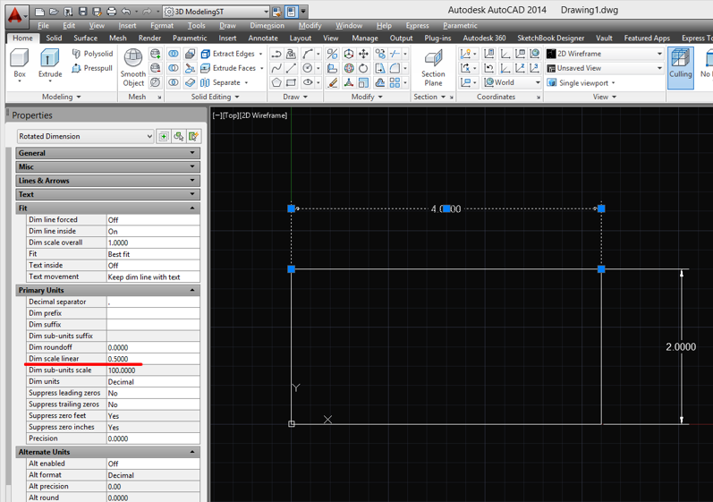

SEANT Posted April 9, 2014 Posted April 9, 2014 If the preference is to keep the dimensions live (i.e., not exploded) then, perhaps, the dim’s LinearScaleFactor property could be set inverse to the detail scaling. Quote
lamensterms Posted April 9, 2014 Author Posted April 9, 2014 Hi guys, SEANT the LinearScaleFactor could be a good option. Would there be a way to get that value to adjust according to the scale, to main a constant dimension value? Quote
Dana W Posted April 9, 2014 Posted April 9, 2014 Hi guys, SEANT the LinearScaleFactor could be a good option. Would there be a way to get that value to adjust according to the scale, to main a constant dimension value? I am no math wizz but would it be LSF = SF * -1? Did I just prove I hate numbers? Quote
SEANT Posted April 9, 2014 Posted April 9, 2014 . . . . would it be LSF = SF * -1? . . . . Actually, it would be LSF = 1 / SF. Quote
SEANT Posted April 9, 2014 Posted April 9, 2014 The property in question is also available in the properties pallet. Quote
