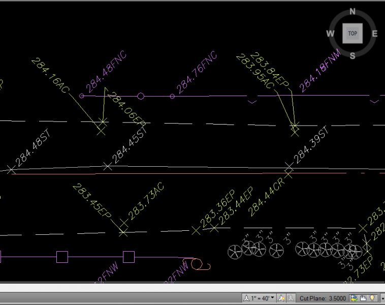

Hello,
So I'm processing a topo that is to be used in 2 different orientations for our project....North (World) and rotated 90*. The majority of the project will be at the 90* rotation view, so that's what I'm processing the topo for.
When I reference the topo into the drawing whose orientation will be World, the point labels that have been dragged with a leader, rotate. However, point labels that don't have a leader and have been dragged are oriented properly. I've messed around with the label style, but I can't figure it out.
Here's what the topo needs to look like (rotated 90*).

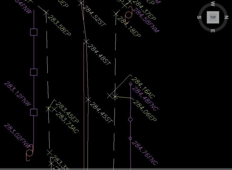

Here's what the topo looks like in World. Notice the labels rotating.

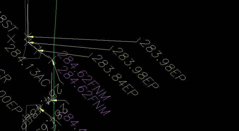

Thanks for your response. However, notice the leader landing now that it has been set to "stacked text."
Change your label orientation to Object. That should fix it.
Leave your dragged state to as composed.
