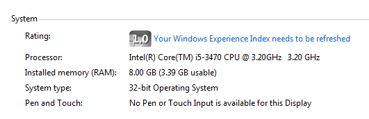

How is it that you have 8GB of RAM but only 3.39GB is usable?
My gut feeling is it's a combination of inadequate of amount of RAM and large file size.
What do you have for a graphics card or is does the system utilize an onboard graphics chip?
If I remember right 32 bit OS could only use 4G RAM, that might explain the low usable number. I can't help but notice that big ol' 1.0 for the Windows Experience. Something is wrong or needs serious updating.

32bit Windows, all versions, can only use 3Gig of RAM: but that shouldn't act as you describe: is this a new problem? Did something change recently on the PC?
Putting 8GB of RAM in a 32-bit system would actually slow the computer to a crawl. While one can put 4GB of RAM in a 32-bit system normally the system will only address about 80% of it and that's with the 3/GB switch enabled in the boot.ini file. One member here will tell you it is possible to go beyond that limit but given what the user has to do to achieve that goal it isn't worth the trouble as most would find the process too technical.

Like RobDraw stated, I would look into the 1.0 Windows experience for a start.
How does 8GB of RAM slow a 32-bit system to a crawl, just curious?
