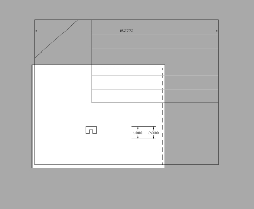

I can't visualize what it is that your saying is cut off, can you post a sreen shot, is it something like this?
No doesn't matter paper size and printer info is from the print driver and setup.
my page is set vertically. i hav 2 10 1/4 wide by 7 1/2 vp views set in paper space. they simply dont fit on the sheet size shown. it measures somthn close to 11w x close to 15 1/2h
is it the orientation that is set wrong , for the verticle ???
sorry I'm not understanding what you have goin on there,....
