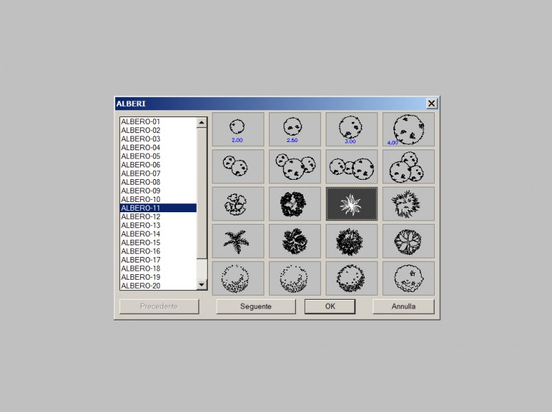

I just found a bug.
when you are in the list en you select the image name just at the other screen (that would be on the previous page as last)
he doesn't go back to the page before (he doesn't "select" an image at that time")
Welsey
  • Replies 77
  • ymg3
    24
  • wesleyaqua
    24
  • Snownut
    12
  • AIberto
    6
Posted Images
wesleyaqua,
Indeed there is a bug there. Do the following change i the action_tile:
(action_tile "blocknameslist" "(setq idx (+ (atoi $value) 1))
                                  (mode_tile (strcat \"sld\" (itoa (- (atoi (substr SlideRef$ 4))(* Pg_No# 20)))) 4)
                                  (setq SlideRef$ (strcat \"sld\" (itoa idx)) Pick t)
                                  (cond
                                     ((> idx (+ (* Pg_No# 20) 20)) (done_dialog 4))
                                     ((< idx (* Pg_No# 21)) (done_dialog 3))
                                     (t (setq idx (- idx (* Pg_No# 20)))
                                        (mode_tile (strcat \"sld\" (itoa idx)) 4))
In the second clause of the cond we should compare (
we need 21 instead of 20.
ymg

Edit the acad.dcl and add width = 25; or another value that satisfies.
before:
after:
acad_icon: dialog {
       key = "label";
       initial_focus               = "listbox";
       : row {
           : list_box {
               width               = 20;
               height              = 21;
               fixed_height        = true;
               key                 = "listbox";
               allow_accept        = true;
           : column {
               : row {
                   : icon_image {
                       key         = "icon1";
                       [b][color=red]width = 25;[/color][/b]                    }
                   : icon_image {
                       key         = "icon2";
                   : icon_image {
                       key         = "icon3";
                   : icon_image {
                       key         = "icon18";
                   : icon_image {
                       key         = "icon19";
                   : icon_image {
                       key         = "icon20";

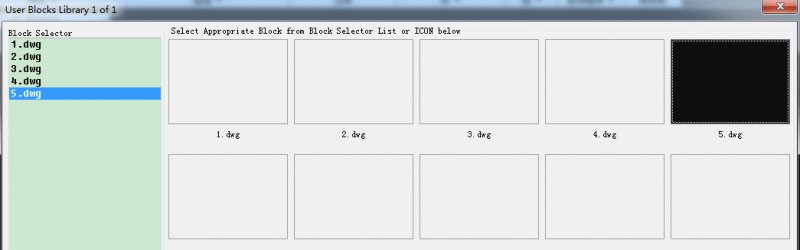

Hi wesleyaqua
Where is the final version ? I test with Snownut's post , but can't insert to drawing .

Two questions , 1. Every time start ,must select library directory? 2.In dialog, the block does not preview ?

What about question 2 ?
No preview
Could you post one of your block drawings, so I can see what the issue may be.
  ymg3 said:
wesleyaqua,
be aware that the method of reading the drawing to get the thumbnail
work only up to release 2013. Up to there the preview image was stored
as a bmp image.
From 2013 the png format is used, and szmaicy's code does not handle it.
ymg
It would appear that the last time the drawings where saved was with a newer version of ACAD, I opened and saved with 2004 and all worked fine.
Although it may be very odd, but I had the same problem not showing previews of dwgs... However I've tried to initialize VLIDE beforehand and to my surprise it worked... So maybe try this modified version... I've also formatted it better and change little end of code as also error handler and added automatic initialization of VLIDE... Strange, but on my A2009 it doesn't work with this trick... So try it with newer releases of ACAD software...
HTH, M.R.

Hi marko , I test with "acad2007, 2010, 2013 " , It's still can't preview.
Just only pop up "vlide" when "userblock" start .
