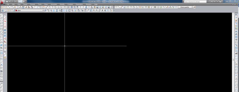

Sengna Posted March 29, 2014 Author Posted March 29, 2014 As i looked closely across from left to right and down across Autocad screen, i don't have the express tool. Does my idol Lee Mac offer this tool on his site? I guess it's time to move to Autocad. 2015. Quote

ReMark Posted March 29, 2014 Posted March 29, 2014 As i looked closely across from left to right and down across Autocad screen, i don't have the express tool. Does my idol Lee Mac offer this tool on his site? I guess it's time to move to Autocad. 2015. [ATTACH=CONFIG]47757[/ATTACH] Express Tools comes standard with full AutoCAD. The option to install it would have come up during the initial installation process. It's possible to add it after the fact but you need the installation DVD to do so. Quote
