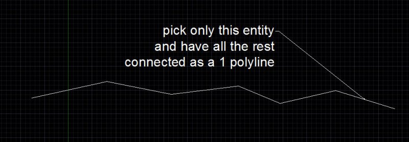

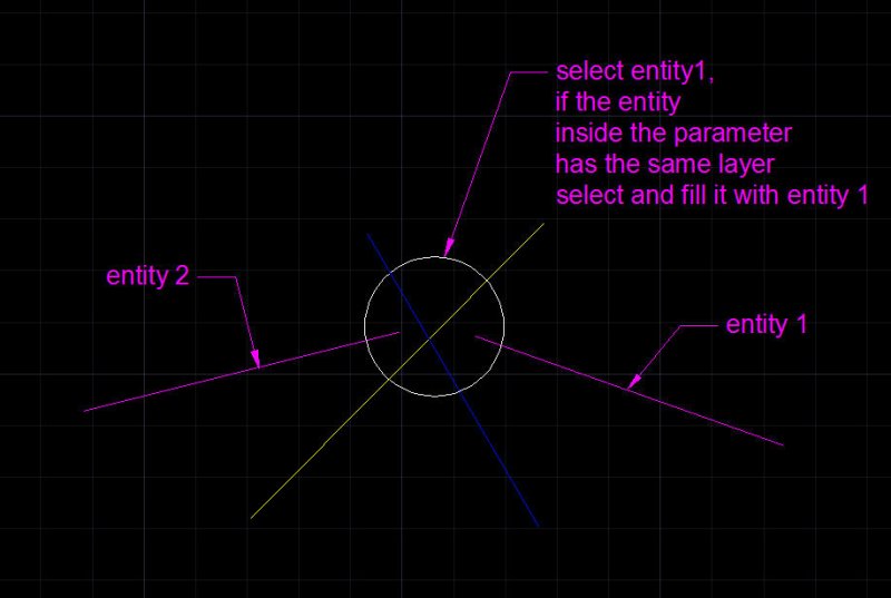

samifox Posted March 28, 2014 Share Posted March 28, 2014 Hi The idea is to simplify a selection of connected lines which are not assembled as 1 polyline. user can select only the starting line , and have all the lines connected to it (or close to be connected to it) joined, and converted into a polyline i was thinking about something like "fillit" command , but i want the selection set to be chosen by a condition see the attached images any ideas? Thanks Shay Quote Link to comment Share on other sites More sharing options...
MSasu Posted March 28, 2014 Share Posted March 28, 2014 This is behavior seems to be already built-in in PLINE command; please check the Multiple input option and Join with Fuzzy factor. For sure will need to select more than one item, but would be possible to write a simple AutoLISP routine or a button macro to automate this. Quote Link to comment Share on other sites More sharing options...

troggarf Posted March 28, 2014 Share Posted March 28, 2014 This is one of my favorites. It joins all objects that touch at their endpoints and all you have to do, is select one object that is among the "chain" of objects. http://forums.autodesk.com/t5/Visual-LISP-AutoLISP-and-General/Lines-to-pline-in-one-step/m-p/3533752/highlight/true Quote Link to comment Share on other sites More sharing options...
