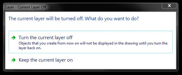

Specific only to one drawing, I launch the polyline command at the command prompt, click on the drawing where I want it to start, click on the next point where I want the polyline and no line is drawn. It gives information, etc. but no polyline. I have checked current layer, color, etc. to no avail. I have purged. I have copied everything into a new drawing to no avail. If I open a new drawing, polyline works as it should. This is happening only in this drawing. Please help.
In such cases first suspect is current layer being set to OFF (the bulb icon).

I'm with MSasu on this one. The layer you are drawing on may be "current" but it may also be "off" as well. Usually one is given a warning when they are about to turn a layer "off" if it happens to be current.

usually the reason behind that is the polyline width. Set the width to 0 and normally it would appear.
