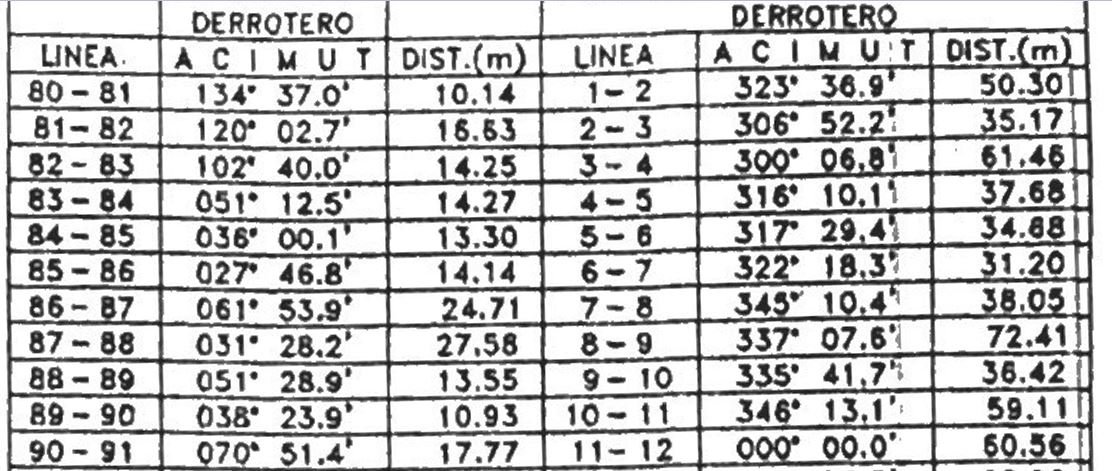

Hi guys!
I'm drawing lines by bearings.
e.g
455.25,
I'm looking for lisp to make it easier.
Maybe someone could help me out.
I'll attached a lisp from Ron Adams. It is a great lips, but isn't working properly.
Thank in advance

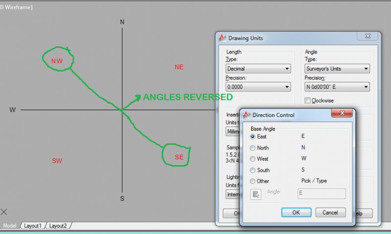

I'm so sorry bother you again. But the code isn't work properly, now NW and SE angle are reversed.
I don't know if I'm doing something wrong,I need a assistence.
The image attached, shows the drawing units to the bearings works.
Thank in advance

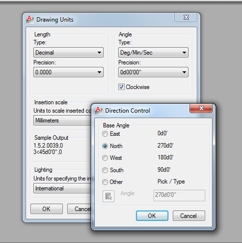

Maduga_SP,
Your Base angle should be set should be set to North,
and Angle Direction to clockwise.
Here I've added an Evgenyi's Error Handler and setting
at the beginning for angbase and angdir.
Upon completion your setiing revert to the initial setting.

...Your Base angle should be set should be set to North,
and Angle Direction to clockwise....
Perhaps this is the source of the problem. The default setting for AutoCAD is base angle at East, and angles counterclockwise. With this setting, the Surveyors angles work perfectly.
Perhaps programmers should allow for the lisp to work with AutoCAD default settings instead of presuming the user has to change the default, which they (the user) would have no reason to do. Also changing the angle settings introduces other effects, such as text direction.

OP really pleased with the goal!!
Thank you very much.
The code isn't depend on the formatting in drawing unit, the correct format is into the code. It's really nice.
really clever way, by the way.
I'm really embarassing to ask you one more favor, but my learning about lisp is too poor and I can't doing that modification.
I have a code that I use very often, design by azimuth and distance, it's a really good code!
I'd like to make the same modification as you did. Set the format units into the code.
Could you make that modification for me, please? :oops:
Thank in advance.
The image attached is the set format to design by azimuth.
File attached

I am out of my element on this subject, but I believe one of these LISP provided here would work with my survey table?
It seems like surveys could be done in bearing or azimut - news to me.
Which LISP would best work for Azimut and distances? I can't figure out how to make these LISP work.
Thanks in advance!
