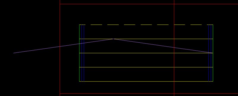

artuiel Posted March 25, 2014 Share Posted March 25, 2014 Hello, I am having trouble with a dynamic block I've created... I'm looking for a way to automate stair drawing. I've made a block that stretches and adds stairs just great- but I haven't succeeded keeping the 'direction arrow' centered, and with both ends at the and-points of stair width... confused? I've add pic's Quote Link to comment Share on other sites More sharing options...

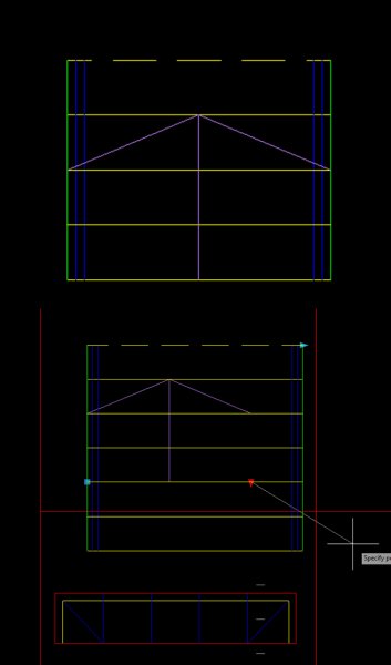

artuiel Posted March 25, 2014 Author Share Posted March 25, 2014 Thanks Dana, that was really helpful I've managed to make the arrow lines stretch to both sides, now to figure out how to make them move to the center of the stretched block... any suggestions? Quote Link to comment Share on other sites More sharing options...

steven-g Posted March 25, 2014 Share Posted March 25, 2014 There are a number of methods, I've shown 2 in the attachment. To get the negative stretch you need to adjust the setting for the stretch direction in the properties pallete, but using the mid point of the parameter as the base point means that is automatic. Stretch In Two Directions.dwg Quote Link to comment Share on other sites More sharing options...
Dana W Posted March 25, 2014 Share Posted March 25, 2014 There are a number of methods, I've shown 2 in the attachment. To get the negative stretch you need to adjust the setting for the stretch direction in the properties pallete, but using the mid point of the parameter as the base point means that is automatic.That's pretty cool Steven. I think for practical purposes, the block that stretches in one direction while keeping the arrow centered would be easier to use in a floor plan, since it can be inserted against one side of the available space, then stretched to the opposite wall. Now the double stretch is better for doors and windows. Especially exterior doors and windows, that are almost always located by their centers relative to the building features. Now that I know some more about the stretchy block construction techniques, I am going to try again to make one myself. Quote Link to comment Share on other sites More sharing options...
steven-g Posted March 25, 2014 Share Posted March 25, 2014 Yeah that's why I showed the two methods, you could also use the centre method and add in a move action set to 50%, but that's getting complicated. Quote Link to comment Share on other sites More sharing options...
