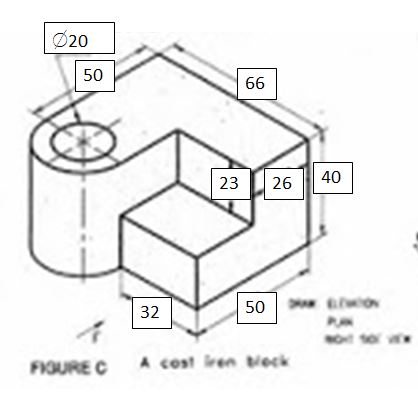

fishwater71 Posted March 24, 2014 Share Posted March 24, 2014 File is attached. I know that I have to do different views. Not exactly sure how to do the front view. Just for starters. Quote Link to comment Share on other sites More sharing options...
ReMark Posted March 24, 2014 Share Posted March 24, 2014 The front view is basically a rectangle that is 66x40. On the right side is a step 32x17. On the left side you'll have to account for the hole that has a diameter of 20. Use dashed lines to indicate that the hole is hidden from view. Should take less than a minute to do. Quote Link to comment Share on other sites More sharing options...

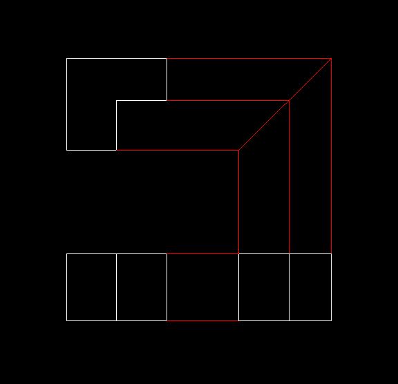

CADgirl Posted March 24, 2014 Share Posted March 24, 2014 It should look something like this. I drew the outer rectangle and then used offset to get the other lines. Quote Link to comment Share on other sites More sharing options...
ReMark Posted March 24, 2014 Share Posted March 24, 2014 I would draw the top view first then use orthographic projection to do the front and side views. That technique was covered in class was it not? Quote Link to comment Share on other sites More sharing options...

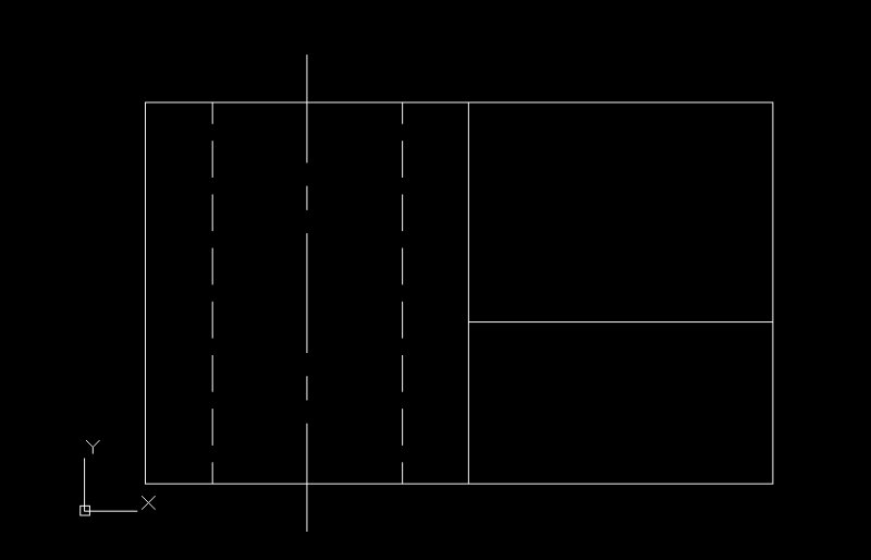

fishwater71 Posted March 24, 2014 Author Share Posted March 24, 2014 This is what I have so far......file is attached. I am having problems changing the linetype for centerline, etc. I am able to load the linetype, I try to use centerline, but just cant get it to work. Thanks again everyone. simple ortho.dwg Quote Link to comment Share on other sites More sharing options...
ReMark Posted March 24, 2014 Share Posted March 24, 2014 Has your instructor covered the creation and use of layers? You've made a couple of class newbie mistakes. The first is that you are putting everything on layer "0" which is the default layer then overriding settings such as color. The second is you are not taking advantage of layers. For example this drawing might have three layers called Object, Centerlines and Hidden. Can you guess what would go on each of these three layers? Each layer would also have a specific color and linetype associated with it so that when a line, for example, is drawn on the layer it would assume both the color and linetype that was assigned. Follow me? Quote Link to comment Share on other sites More sharing options...

ReMark Posted March 24, 2014 Share Posted March 24, 2014 See if this makes a little more sense. I'm not finishing it for you. simple ortho_redux.dwg Quote Link to comment Share on other sites More sharing options...
fishwater71 Posted March 24, 2014 Author Share Posted March 24, 2014 Created a centerline layer and hidden layer. Tried to change the 0 layer to object layer, but unable to rename. Now I really have not much clue what I should do now with the different layers. THANKS again Remark. Ever make it to Las Vegas I owe you a drink or 2. Quote Link to comment Share on other sites More sharing options...
fishwater71 Posted March 24, 2014 Author Share Posted March 24, 2014 See if this makes a little more sense. I'm not finishing it for you. [ATTACH]47655[/ATTACH] I am seeing what you did there. Created the different layers then assigned different colors to each layer and also line types. Helps a lot.....thanks. Quote Link to comment Share on other sites More sharing options...
ReMark Posted March 24, 2014 Share Posted March 24, 2014 Layer "0" cannot be renamed. Create an Object layer and put all your geometry on it just like I did in the DWG I attached previously. Don't put anything on layer "0". Use that layer only for creating blocks. I was in Vegas back in August. You should have bought me a drink then. lol Quote Link to comment Share on other sites More sharing options...
