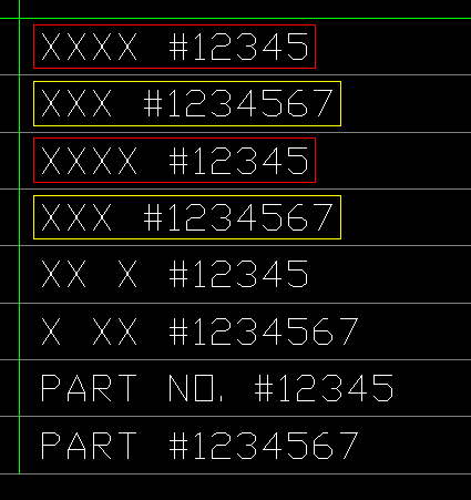

I'm looking for a way to check my BOM lines (mostly copied from multiple drawings) for duplicate part numbers (all number, no alphabets but might have - or _) in an attribute block with a tag named DESCRIPTION & SAPNUMBERS.
Example
If the description says 12345 in one line and if the same is found on the another line in the description column then thats duplicate. Similarly on the SAPNUMBER column as well. If one of these return true then I will evaluate both the lines manually.
Dont want to delete anything here. Just want to make sure I dont have same line repeated twice on the BOM. If found, I will just adjust the qty and delete one. Thats manual work that I do.

Nop. each BOM line is one attribute block and same is copied multiple times to make complete BOM.
So how do you propose to show the duplicates then?
May be highlight two entities. In most cases there are only couple of duplicates. If all duplicated are highlighted, it wont be difficult to work thru the selection. Do you have any better idea?

What i was thinking was, iclude colros for duplicates, say there are 5 "12345" all of them would be "boxed" with the same color. would you want that?
as for the "" blank items its an easy modification.
After bit of trials, I found that lines work well and becomes very easy to remove as well. Its a great idea to color the boxes but considering the very limited instances of duplicates, it may not be that useful and also makes difficult to visualize the numbers. But it may be very usefull if the large data and more number of duplicates.
For now, I think just the blank line issue is just need to resolved.

pBe,
This one is much better. After a couple of trial, I learned that it looks for a whole text line and compares with another and not just numbers. For SAP numbers, this is a perfect way. However for the description, since the desc. is written manually, there are chances that user may have written differently or may have abbriviated it. The only constant is a part number that dont change (ie. 12345). So, I just tweaked desc. and ran it again and this time result changed.
But, aleast SAP number is catching the duplicate even if the desc. is messed-up. So I have one or both places to catch the error and one is enough to pay attention to the whole line.
I thank you for the effort you have taken to help me thru this.

I'm creating a small routing that will erase all entities on the Duplicateline layer. That way I dont have to erase it manually.
So do you still need help in tweaking the code? or you can handle this on your own?
As for the Description tag, as long as the # sign its an easy modification.
# sign is not consistant between drawings. I have also included the Drawing_Number tag in it. So I have now 3 levels of checks which should be enough to catch error.
