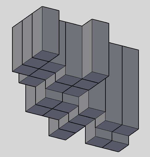

Create the squares using the polyline command (so it is one continuous entity) then use the EXTRUDE command specifying a negative "Z". It would probably be a good idea to be in one of the four standard isometric viewing modes when you do this so you can see the result.
First step is to create your grid of squares.
Second step would be to extrude them in the negative "Z".
In the example above squares have been extruded anyway from -6 to -10 units. Kind of difficult to see though from this perspective.

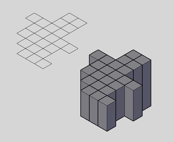

Our group of extruded squares after rotating using the 3DObject, or 3DO, command. Now we can better visual the difference in the various extrusions.
BTW...each square is 2x2 units. There are 23 separate squares.

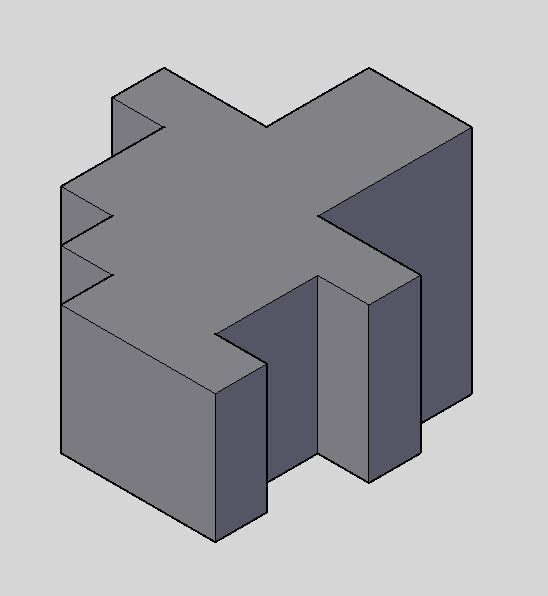

What our 23 separate squares would look like if combined into one 3D solid using the Union command.
Now we can find the volume using the Mass Properties, or MassProp, command. This is what the result would look like:
Volume: 632.0000
