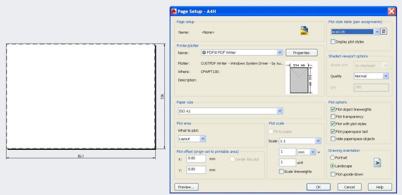

You are correct, your A1 borderline/title "block" should not need to be scaled.
It should drop in so it fits just inside the dashed rectangle on your paperspace image. That dashed line represents the printable area of your paper.
You say you are working in mm in modelspace, yet the measure tool shows your borderline in inches, apparently.

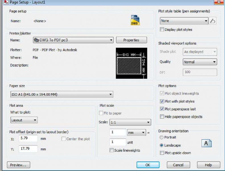

Below the scale window is your units option, set it to mm. Now one paperspace mm = one drawing mm.
Here is a picture of what the page setup dialog should look like with these options selected, with the exception of the plotter/printer. I have it set up to plot to a A! pdf since I don't have a wide format plotter handy here at home.
If all is good to this point, you can move on to adding a viewport to your layout and giving the viewport itself a scale that will accommodate what you want to show on the paper.
