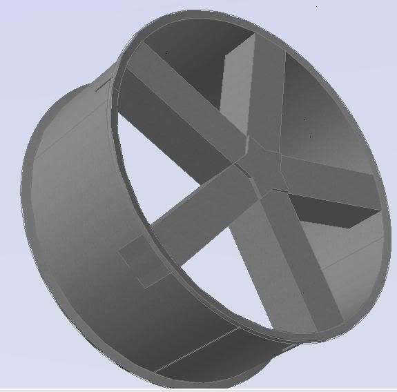

plively Posted December 3, 2008 Author Share Posted December 3, 2008 Dont get me wrong, im familiar with most of the general functions. I'm just having problems with creating the inner part of the rim. I have the outer shell, just confused on where to go from there. Quote Link to comment Share on other sites More sharing options...

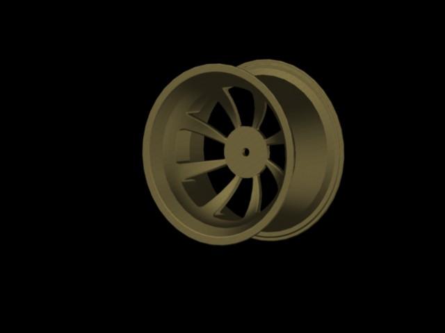

shift1313 Posted December 3, 2008 Share Posted December 3, 2008 there are a few ways you can do it. First way would be to draw your 2d profile of the rim(bead area) all the way to the hub. then subtract spokes. If you have something more "creative" in mind for your spokes, draw your outter rim, draw your inner hub, then draw a guide and two 2d sketches, one at the hub, one at the rim and loft. I did this in another package but have done this with acad before as well. The second pic was done in acad07 creating a rim "blank" and subtracting spokes. Quote Link to comment Share on other sites More sharing options...

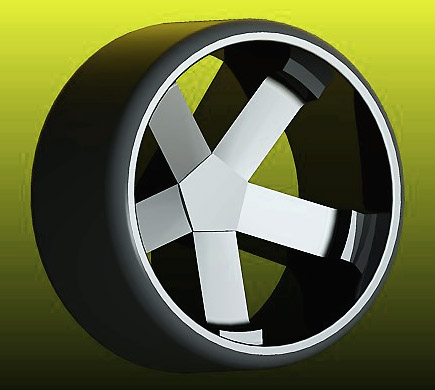

rgarjr Posted December 3, 2008 Share Posted December 3, 2008 Nice wheels shift, here's mine. The difficulty of drawing a car wheel depends on what shape or design it has. Quote Link to comment Share on other sites More sharing options...
shift1313 Posted December 3, 2008 Share Posted December 3, 2008 and how much detail you want:) rgarjr, did you draw the entire profile and revolve that wheel? Quote Link to comment Share on other sites More sharing options...
rgarjr Posted December 3, 2008 Share Posted December 3, 2008 Nope, just drew the spokes 2D, then extruded. Back then, I used to have a thing for chromed dipped iroc-z wheels. Quote Link to comment Share on other sites More sharing options...

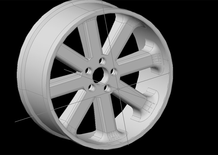

plively Posted December 5, 2008 Author Share Posted December 5, 2008 Thanks guys for the help. heres my rim..I know its pretty rough but I have a couple other questions. How do you get the material for your rims? I know its something like RMAT but im having problems with that. Also, is there anyway to subtract that extra little material where the spokes meet with the shell? Thanks guys for the help. Quote Link to comment Share on other sites More sharing options...
rgarjr Posted December 5, 2008 Share Posted December 5, 2008 Cool rim. To remove that little piece there's quite a few options for that. U can offset the face of the rim a little, you can Slice it with a surface. Revolve an inverse section and then subtract. To add material u need open up the Material palette and create them. Quote Link to comment Share on other sites More sharing options...
shift1313 Posted December 5, 2008 Share Posted December 5, 2008 Thanks guys for the help. heres my rim..I know its pretty rough but I have a couple other questions. How do you get the material for your rims? I know its something like RMAT but im having problems with that. Also, is there anyway to subtract that extra little material where the spokes meet with the shell? Thanks guys for the help. the center part of your rim looks to be just a cylinder so you can make a cyliner that encompasses your spokes and is the same OD as your inner rim part and use the intersect command as well. Or you can draw two cylinder, and subtract. Acad 09 has tons of materials already loaded. You can look online and use your own materials if you like. Go to your material settings and there is a drop down for metals and advance metals. Quote Link to comment Share on other sites More sharing options...
