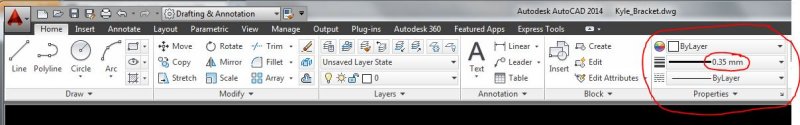

Dana W Posted March 17, 2014 Posted March 17, 2014 Whichever layer I use I still produce lines with a 3.5 line weight. Can you please advice me how one changes this to default to the specified line weight of the layer used. (So glad there are people out there that enjoy helping) Is the line weight drop-down list button on your toolbar or ribbon showing the 3.5 or By layer? Is the color drop-down list button showing By Layer? These will show the CURRENT line properties for the drawing. Change them to By Layer. Quote

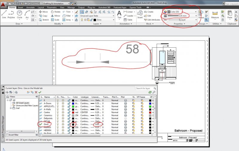

grain Posted March 17, 2014 Author Posted March 17, 2014 You've bullied me into it. Please find the drawing attached. Grain.dwg Quote
ReMark Posted March 17, 2014 Posted March 17, 2014 Are ALL the lineweights shown in your Layer Properties MANAGER correct? Yes or No? The very first thing I notice when I open your drawing is that although you have the Dimensions layer set as current with its lineweight set to 0.5 and color set to black (in the LPM) these settings are being overridden and instead the lineweight is 0.35 and the color is gray 253. Quote

Dana W Posted March 17, 2014 Posted March 17, 2014 Sorry my post was out of sync then. ReMark I don't understand what you're trying to say. Do you know how I can correct this problem. I've no idea how it was caused as no one else has access to my computer.Yes, as mentioned twice, you select the dropdown list(s) that ReMark has circled in red, and change them to By Layer. Quote
ReMark Posted March 17, 2014 Posted March 17, 2014 As you have been told, stop overriding your settings. Look at the Properties panel on the Home tab of your Ribbon (see image posted previously if you don't know what I am referring to). Set the Color and the Lineweight both to "ByLayer" and leave them alone. I can hazard a guess as how it might have happened but I won't say unless forced to. Fix it. Don't do it again. Move on. Quote
ReMark Posted March 17, 2014 Posted March 17, 2014 Thanks Boys! You've done the same thing to your "No Print" layer too. In model space you overrode the color from black to cyan. I suggest that you have a separate layer for your viewports and set it to no print and also give it a color other than black (magenta is a good choice) so it can be easily distinguished in your layout. Quote
