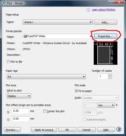

I need to print out to scale on a piece a paper thats 36" wide by around 5' long there is not a paper choice for me to set it up in layout? Do I set it up in Model space? Thanks for any help.
Whgen you plot go into the printer properties

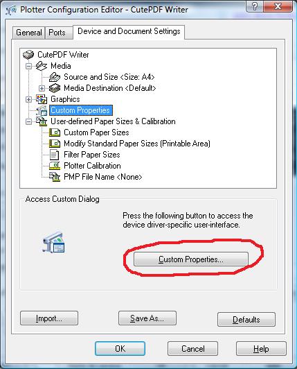

and then open up the custom properties,
Once there depending on which printer you've got - (you'll have to explore a bit) there should be an option for custom page sizes
thanks, that worked perfect!!
