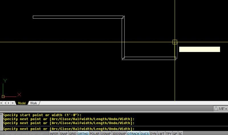

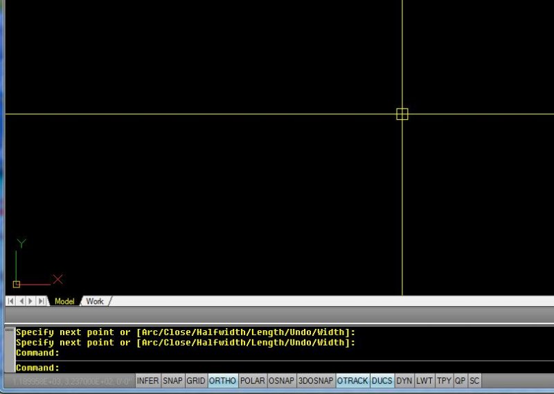

2cook2 Posted May 18, 2011 Posted May 18, 2011 When I try to use this routine it works fine up until I hit enter after drawing the ducts. Then everything disappears and there is no error message. I must have some setting messed up. Any ideas? Everything's OK. Hit enter and it's gone. Quote
MarcoW Posted May 20, 2011 Posted May 20, 2011 Go back in these posts and try some erlier version. Does that work? Quote
