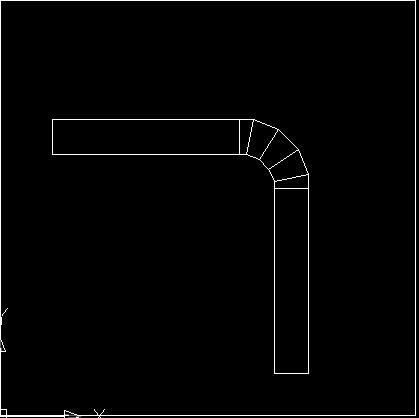

Ronso Posted May 19, 2009 Posted May 19, 2009 MarcoW, If I understand your thread, you are unable to hatch the segments created as multilines. I have revamped the programming in the attachment to produce all straight segments and corners as polyline objects so that hatching is possible. If my understanding is incorrect, please explain your request in further detail. WPIPE[5].LSPFetching info... Quote

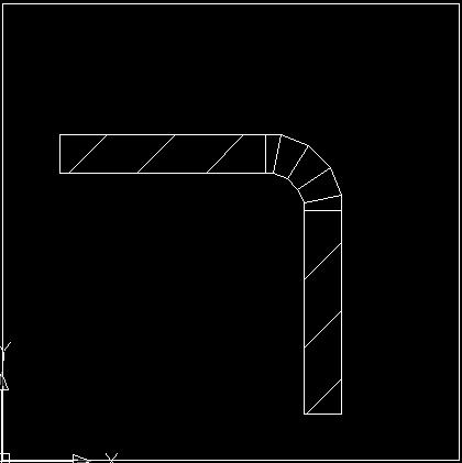

MarcoW Posted May 20, 2009 Posted May 20, 2009 Hi Ronso, Thanks a lot ! Now it is "hatchable". Below i have 2 images of how i hatch; first draw wpipe, the segmented versions, ie. start with = 125mm... Then after finishing wpipe i select all the straight pipes (not the segmented corners) and then hatch those straight lines. Your answers helps me a lot. Thanks again. Now i am gonna try to set up a lisp for hatching only the straight pipes sof the segmented wpipes... Or do you have an idea of making an extra function in the lisp like: "Do you want your wpipe hatched when finishing command No:" I'd say somethinh like: (defun hwpipe () ; as a subcommand in the wpipe command (command "hatch" "p" "ansi32" "50" "0" "s" pause "") (princ) ) Where "s" should be automated; it should select all straight drawn wpipe's. Do you know what i mean? If not i'll explain it to you. I'd be very grateful for your help! Quote
Ronso Posted May 20, 2009 Posted May 20, 2009 Seems the new attachment should fit your request... WPIPE[6].LSPFetching info... Quote
MarcoW Posted May 23, 2009 Posted May 23, 2009 Ronso said: Seems the new attachment should fit your request... I can assure you: the new routine does fit my request! My macro's are a little bit altered so only the desired pipes wil get hatched. You really did a great job on this one, thank you very much Ronso! By the way: this is one of the most beautyfull lisp routines I ever found, I don't get much of the programming for it is a little too much for me, but i can tell there's a lot in there. Good thinking i mean. Tnx again and see ya soon for I have a thousand ideas Quote

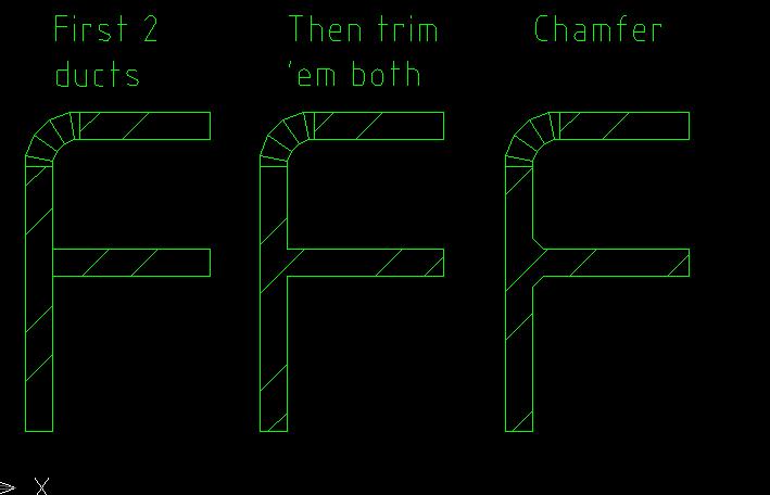

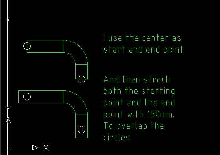

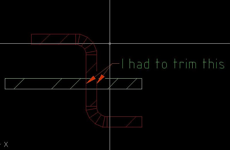

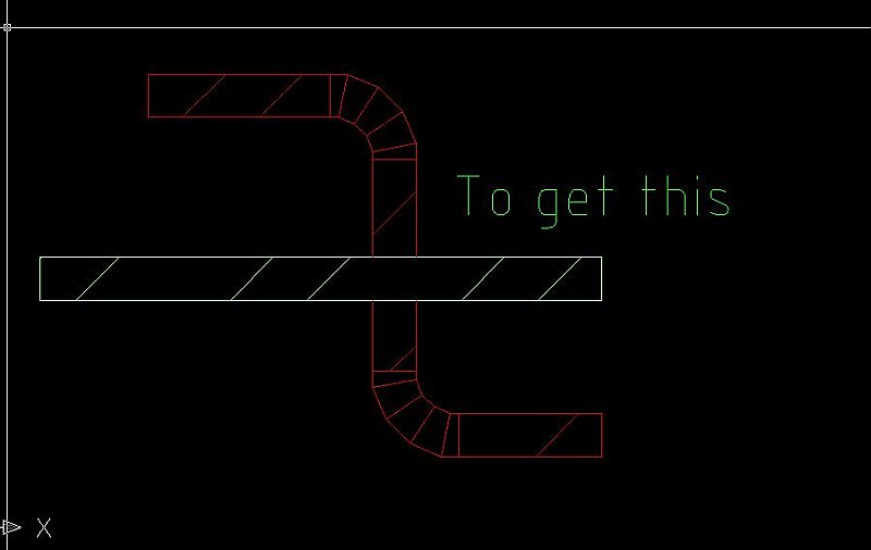

MarcoW Posted September 19, 2009 Posted September 19, 2009 These things I come across whenever I use the wpipe lisp. The solutions may not be in the lisp itself but maybe in a kina "edit wpipe" lisp. Perhaps it's even more simple, that I overlook it. Question 1. Look at my first GIF; I try to put one pipe behind the other, it looks as if one is going under the other. Can this be automated in a way? Question 2. If you look at the second GIF: this is how I create a T (don't know the right english name for it). I use trim and then chamfer. Can that be automated? I can't get started ... I mean I don't have a clue how to approach these things. Question 3: Is it possible to strech the wpipe so it overlaps a certain distance? See GIF 3 for that one. Maybe in a way like prompt for the end of the wpipe that should be streched with a certain distance..? Any help is welcome, as allways ! :reallymad: MY GIF are too large I can't upload them :reallymad: aarghh... monday is a new day Quote

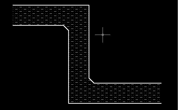

VisDak Posted September 20, 2009 Posted September 20, 2009 I like this Route for Ducting works for faster continious ducting layouts, can it be possible to add on selection also as chamfered bend at the closer corners side cause it is similar to cable trays layout only on cable trays camfered at 150mm on corners, kindly see image attached that i like to work through advance thanks to all, Quote

MarcoW Posted September 22, 2009 Posted September 22, 2009 Well, again: MarcoW said: These things I come across whenever I use the wpipe lisp. The solutions may not be in the lisp itself but maybe in a kina "edit wpipe" lisp. Perhaps it's even more simple, that I overlook it. Question 1. Look at my first 2 GIF's; I try to put one pipe behind the other, it looks as if one is going under the other. Can this be automated in a way? Question 2. If you look at the third GIF: this is how I create a T (don't know the right english name for it). I use trim and then chamfer. Can that be automated? I can't get started ... I mean I don't have a clue how to approach these things. Question 3: Is it possible to strech the wpipe so it overlaps a certain distance? See GIF 4 for that one. Maybe in a way like prompt for the end of the wpipe that should be streched with a certain distance..? Any help is welcome, as allways ! :reallymad: MY GIF are too large I can't upload them :reallymad: aarghh... monday is a new day I have no animated gifs so here the JPG's, and NO I am not that handy with it. It looks like a bit rubbish... Sorry for that. Quote
Lee Mac Posted September 22, 2009 Posted September 22, 2009 Marco... you are asking a lot here - I doubt many people have the time to make modifications that are this large... See Ron's link above Quote
