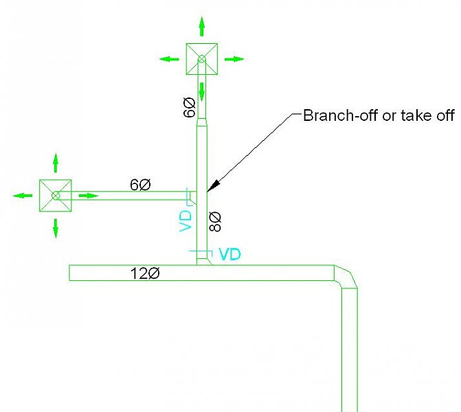

cadmando2 Posted January 28, 2009 Share Posted January 28, 2009 Is there a way to create a second lisp routine to be able to select the duct just created and make a branch-off and pause to select witch side to place the 45 degree and the VD “Volume Damper” symbol and continuous making duct. Could you create a second lisp routine to create Branch-off? It would be nice to have a complete set of duct lisp routines. To select a existing duct just created using Dpipe.lsp and pause to allow you to select witch side to place the 45 degree and insert VD “Volume Damper” symbol and continuous making duct. Quote Link to comment Share on other sites More sharing options...
