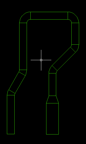

As far as my needs go, the Arc feature is not necessary. The arcs you draw automatically are fine. Only the arc is a bit wide, it doesn't have to be so big.
You can also remove the Length option, because it seems you can just type a length as you are drawing, without having to use that option. And this works fine. But when I DO use the Length option, it changes the length of the previous segment, not the one I'm currently setting. So I don't need that specifically.
I'm only saying to remove them so that the code can stay smaller and simpler and not get to complex with features and extra clicking.
So there are three things I'd want to change:
1) There is no need to specify the 'start width' for making the transitions between duct sizes. You can just assume that the start width is the same as the previous duct width. So in other words, while you draw, and use the Width option, it only needs to ask for the new width, and then you can do the transition with the previous width as the start width. If that makes sense. That would eliminate an extra click, because I'll never change the start width.
2) Make the corner arcs a little tighter. This lets the turns and segment lengths get shorter around corners. Sometimes I have to make pretty tight corners, and if it is to close, your program can't make the arcs.
3) Allow ESC and space both to be used to end the command. If I draw duct for a while and press escape, it looses everything. This is bad habit on my part, because Multiline let you press escape, so sometimes I press esc instead of space and loose what I've drawn. So please allow ESC!
Other than that, you can keep the code simpler by not having the Length and Arc features.
I hope I don't sound picky, I'm just trying to streamline the command so that it has only what I need, and nothing I don't, so there is as few clicks as possible, and less complexity. Remember KISS!
You are awesome! Thanks!
Also, I don't know what Halfwidth is. What is it? I wonder if I need it either.
Thanks again.

The idea is to have a very specific command without any unnecessary features that may not be used. It is so very close to perfection! lol
I know it. But it's a one of a kind script.
My boss said this is the holy grail of LISPs, they've been dreaming about a duct script like this for years.
Seriously, once it's complete, he could sell it. I'd put it up on hotscripts or wherever, and set up a paypal to charge a little, I think it would be worth it.
I hope I'm not asking to much, that's why I said to remove the halfwidth, arc, and length commands, so he doesn't have to spend time perfecting them. Just stick with the basics. Removing the asking for "start width" should make it simpler. I figured changing the arc radius is just popping in a new number, I dunno.
It's very good though, I'm very grateful!

It's kind of a hard thing. Because if the script isn't removing the necessary steps, I might as well keep using multiline. But actually the script is more than usable right now, I'm just talking about removing the rough edges.
It's only about 300 lines of code. Heck, I've written scripts up to a thousand lines or so for free over forums in VB and PHP and other languages I know. I just wish I knew LISP.

Ya, the script works fine, I know, I'm using it too. But there is no need for some of the extra features, I'm trying to tell him that he doesn't have to put MORE time into it making these features if they aren't necessary. In fact he can remove them to make the code smaller and quicker.
Simplify simplify simplify!
Now with correct radiuses for all corners. It was necessary to remember secondary school, namely the 'law of sines' and the 'law of cosines'. In the first program I simply made _offset and it was not necessary to think of it. Excuse that so long - it was necessary to alter urgently one project.

Great lips work there, ASMI.
Vigilante and Stykeface, can we keep the banter down on this thread and keep on topic. i think its developed into a great thread, one that has not been seen for a while [ brings back memories of Fuccaro's lisp's years ago :D]
G
I have executed some wishes of Vigilante. Now it is possible to not enter width each time and a pipe remains by pressing Esc.

Now in occasion of superfluous options.
Unfortunately here there are restrictions.
I can represent on the screen a dynamic double line in three ways. 1) a standard wide polyline (that that is realized in the program) 2) the multiline 3) function GRREAD.
But all has the lacks:
1) I cannot to hide messages of this command as if it is necessary to change width, you will not see any message. Also I cannot add the own options in a standard command.
2)Cannot change width and add own options.
3)All options possible, but large additional code and snaps do not work.
There are two ways by means of which it is possible to make any options.
1) To refuse a double dynamic line.
2) To use DynDraw200X.arx (free). The special file written by fine ObjectArx programmer Alexander Rivilis. It works as function GRREAD, but with snaps and transparent commands, such as change of snaps, swich on/off Orto, etc. In this case it is possible to clean not the necessary options and to add necessary. For example change Justification during of a command, the round caps (if it drop or sprig), change of width with automatic drawing of reducer etc.
But I am not assured yet, whether it is necessary to me to begin this code as it absolutely new code and there anything from that that will not be already written. Also I can tell that it large code, I think more than 1000 lines. :?:
ASMI, it is no problem if you can't remove the extra options. I didn't know they were part of the dynamic double line. I thought that they were options you added specifically.
So it's fine if you leave the arc and halfwidth options in there, I just won't be using them, but don't put any more time into fixing them if you don't want to.
The only option that I would want changed is having to put "start width" in there, it isn't needed. But if it is hard to change then don't worry about it. You have done so much already!
And Justification is not needed very much either, so I don't want you to work on it more then is reasonable.
Thanks again.
>Vigilante
It is good, while we shall leave all as is. Do yo like last code with 'Specify start point or width :' query? Now you do not need to specify wide every time, you can specify wide or pick start point.
Yes that's great.
Really you could probably sell this script!
Thanks a ton
