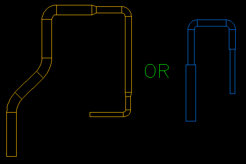

>Vigilante
Now pipes is multilines and coners is closed polylines. But change widths within the command while unavailable. It so is important? Possible to repeat a command with new width? It's possible but I had small time to do it.

Ya, that is pretty much it, it's air duct.
I've attached a couple images to show kind of what ours looks like, and what I'd like my dream command to do.
duct.jpg is an image of what I'd like the command to be able to do in one fell swoop.

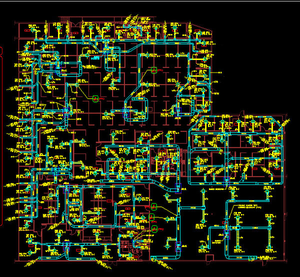

duct2.jpg is an example of a job I recently did.
Now imagine how much time could be saved on that job if I had a faster way! Imagine that I had to draw every arc manually, and every transition. That is a lot of exploding, trimming, drawing, stretching, texting, capping, and more!
Just by giving me rounded corners, you have saved a lot of time!
