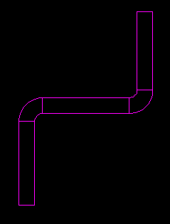

Hi all, I'm sure this is out there, if someone could point me in the right direction.
We have acad 2002 and used to use 2000.
In 2002 we have the mline command which is pretty simple. But in 2000 we had the doubleline command which was much more powerful.
Basically, I draw a lot of double lines which step down in size and make turns.
So, for example, I'll start a double line at 20", draw horizontal for a bit and step down to 16". Then I might make a 45 or 90 degree turn, and continue on, possibly step down some more.
It would also be really cool, if when making a turn, it automatically arcs the corners appropriately.
So in 2002, I have to draw a 20" double line, stop it, cap the end, start a new double line at 16", go on and turn, stop, cap it. Then I have to go back and manually arc the corners and erase the square ends. I cap off the mline so I can start the new mline on center, plus it's needed later.
So, it would be special to be able to continuously draw a double line, step it down, make turns that auto-arc, without having to stop the command at each point.
This would save tremendous time.
How do I? Thanks.

I wrote one for myself some time ago. See if it can help.
; Draws continuous pipe (or duct) of any size
; with user defined inner bend radius (default = 0.0)

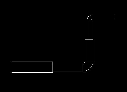

Nice, I played around with it a little, it's alright. Only thing I would change, for my own purposes, are these:
1) I'd like to see the lines as their drawn, rather then a dashed line, because I have to size things as I draw.
2) I'd like justification, like mline, for alignment.
3) It would be ok for the radius to be calculated as a quarter of the line spacing. So if the line spacing is 6", the radius can just be 1.5". That would save a step.
4) Lastly, and most important, I want to be able to change widths while still in the command. So if I start drawing at 6", I want to change width to 4" without stopping the command. The double line should be capped where the larger width stops and the shorter width begins. And the shorter width is still centered on the larger. And if I change width, or course the radius would have to change with it.
5) Lastly, on any curve, the double lines should be capped where each arc begins and ends.
I attached a picture of the type of thing I'd like to draw with a single command, all in one motion. Mline can't change width mid-way. The Dline can but arcing corners is impossible to me and it has to many options. Your BD script does the corners but doesn't have those things mentioned.
Refere to the picture, can anybody help tweak a script or know where I can do this drawing with one command?
Thanks, the suggestions thus far already save many steps in creating this drawing.

Well, I am trying to imagine the user input for the figure like the one on the picture.
Every segment, the routine would have to ask if there is any change in size for the next segment.
The same goes for “justification”. If it is other than symmetrical, there would have to be some more questions answered before program could continue after each change in size.
Does the next segment always continue in the same direction following the change in size?
Do you always want to start from the large size and decrease it during the program execution, the other way around, or should it be possible to draw it either way?
You know the variations you want to be able to draw. Try to imagine all possible scenarios and the user input for each case and post it here.
I didn't quite get your comment #1. I can't see any dashed lines when I use the routine. Do you? Every segment is visible as soon as you enter the next point, isn't it?
Hello! Thanks for your willingness to help. In answer to the issues you raised:
You are correct, each time you "click" to stop a segment, you should be able to put in a new width. This is how the mline command does it. Without interrupting the command.
Justification does NOT have to change mid shift. That is just an option when you first start a new multiline. And if you don't put it in at all I won't complain. KISS.
Yes the segment always goes in the same direction after a size change. So basically on every possible turn or corner, both sides are the same size. Size changes are usually before or after a turn. Rarely I will have to change sizes at a corner, but I don't need a single command for this. I'll just stop the command and start a new one. Because such corners are not rounded, and have other special features.
And I do only go from larger to smaller sizes. For my specific purpose, I would not have to go smaller to larger. But it seems like that wouldn't be hard to add, so both would be good, but not necessary at all.
As for the dashed line, yes the segment is visible AFTER I click to end the segment. I'd like to see the two lines AS I draw them, rather then only after I click. Refer to how mline works. There is the dotted line, but you can also see where the two lines will end up, before clicking to end the segment.
Here is a theoretical command chain that would work for this:
I type the command "xyz"
Options available "justification (bottom/center/top), size"
'Click point to start...'
Options available "size"
6 ">
<....continue clicking to end segments changing sizes....>
So basically, I only to end a segment. I shouldn't have to click after changing size. And remember the ratio is a quarter of size. And that segment ends are capped. And capped at corners as well.
Thanks again if you actually work on this, that would be cool!

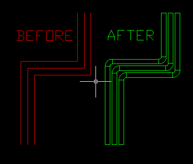

hell, paul that lisp is great. i think it's gonna go in my Startup Suite, haha. i'll use that a lot. one thing would have been nice, is to have an endcap when completing the line. but hey, no complaints here. lol 8)
Like this?

It seems good idea to me has come. It is possible to transform existing polylines to pipes.

One more modification for one step Undo, [Length/Undo] in command line and restoring default polyline width:

Looking good guys!
Now if only we could blend the two scripts so that all segments are capped, and I can see both lines as I draw, to know where they'll be. And, or course, be able to change widths within the command.
AMSI's script shows both lines, and caps all the segments, and I like the undo thing.
I like how Paul's script rounds the corners as you draw, rather then at the end of the command.
These scripts are so close to doing what I need!
I'm not sure if it's better to have polylines or not. When I use mline I normally end up having to explode so I can edit the lines.
However, it would be good if the entire duct, or everything created by a single command, is all one selection/object/line, whatever. Like mline.
In other words, imagine I create a string of duct and maybe 2 or 3 corners. But then I have to move all the duct 3" down. If all the duct drawn was a single line or block, I could just grab it and move. But if not, I have to try to select all the duct line by line and then move it.
I don't want to sound picky! It's just that the scripts are so close I'm kind of excited! But without being able to change sizes midway, it's just the same as mline except for rounded corners.
And whatever calc ASMI uses for radius should be added to yours, Paul. Unless naming a specific radius is needed. It's not, in my case, the radius can be calculated automatically like ASMI's. The idea is to remove as many clicks and commands as possible, to draw this duct like shown on page one.
Blast, I wish I knew LISP! Got any good beginner tutorials around here? I'm not a stranger to programming, I know Visual Basic, some Java, C concepts, PHP, so I should be able to jump right in.
Thanks again, good stuff! If you create this script so that the drawing in page 1 could be drawn in one command, there is only one more thing to add to make it complete! You have no idea how much time and effort this will save!
