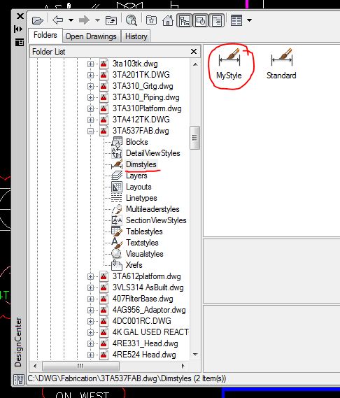

Yes, you can drag-n-drop a DimStyle (ex. - MyStyle as seen in above image) into an open drawing via the Design Center. Don't forget to make it current though. You could probably do something similar by putting your custom DimStyle on a Tool Palette.

Sengna: If you'll take a closer look at the image I provided you'll notice I clicked on a drawing not on a folder. All the objects you mentioned will be found in your drawings.
