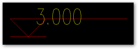

Modify dynamic block XYZ scale factors. need help !
Modify X, Y, and Z scale factors.
There is a dynamic block,Through the properties dialog to modify the XYZ scale factors, is ok!
But I use a lisp to modify xyz scale factors ,There is a problem.
Thank you for any help!Be grateful!
xyscl.lspFetching info...
So the text is a Dynamic Block and you want to relocate it by scaling it to X = 2.0 and Y = 2.0 and Z = 1.0 ?
Yes,use lisp,text scale does not change.
Drawing1.dwgFetching info...

  Tharwat said:
I could not try the code on your Attributed Block due to the name is written in unknown language to my system , so anyway try it and let me know .
Tharwat,Thank you very much ! is nice !but not support normal block .

  Tharwat said:
It is much easier with Normal Blocks ...
NOW,can support normal block. but Dynamic Block have problem. After change the dynamic block.the text of dynamic block is missing!
In addition,Just want to input scale value once.Not need to enter 3 times.
Use the first lisp for attributed Blocks and Dynamics as well and use the second one for normal blocks .
