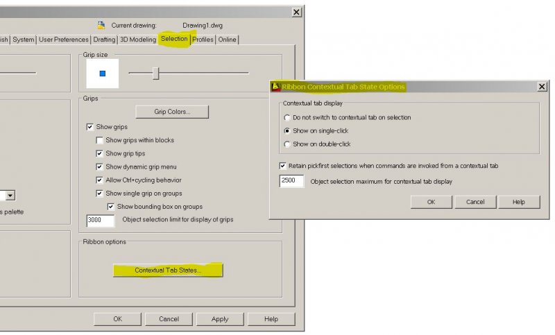

You're talking about doing your annotation in paper space, correct?
I have never used Civil 3D, but wondered if you might have similar
settings to these available to you in OPTIONS, and if so, if you have explored them?
Guest Trekiez
In the image Dadgad is showing, change the option from 'Show on single click' to 'Do not switch on contextual tab on selection'
Thanks for those suggestions Dadgad & Trekiez,
I already have mine set to do not switch on contextual tab selection & it still switches when changing form model to paper or model tab to layout tab & vice versa.
