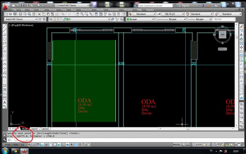

ekolman2003 Posted February 27, 2014 Posted February 27, 2014 how I write area command result, middle of the room ? Quote
BIGAL Posted February 28, 2014 Posted February 28, 2014 There is two simple ways, 1st use a pline and one of its properties is the area, 2nd is use Area command pick points and retieve the Autocad variable "Area". 3rd more complex is to use a ray trace program just pick center of room. All 3 then just write a text answer. Which do you want ? Quote
ekolman2003 Posted February 28, 2014 Author Posted February 28, 2014 I use area command. and then I pick points anywhere. lisp write area there:) Quote

ekolman2003 Posted February 28, 2014 Author Posted February 28, 2014 I m calculate room area,with autocad "area" command. but this command Show result but not write. Quote
David Bethel Posted February 28, 2014 Posted February 28, 2014 After the AREA command is complete, the area value is stored in the sysvar AREA. You can retrive it with (getvar "AREA")l. -David Quote
ekolman2003 Posted February 28, 2014 Author Posted February 28, 2014 this lisp super but it hasnt got subtract area and it isnt scan green selected area autocad area komutu.lsp Quote
