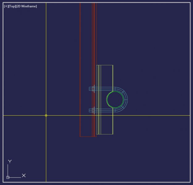

Why did you select 2D wireframe and not 3DHidden since you are showing both sides of the channels?

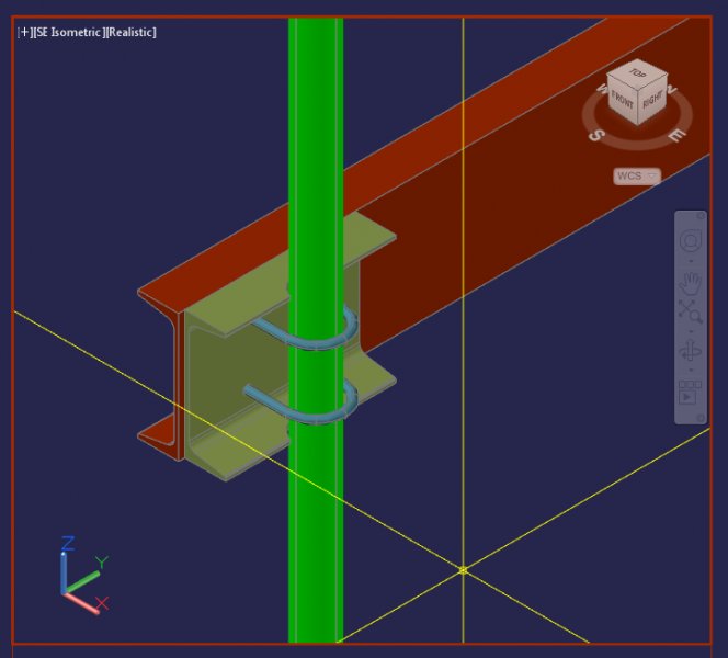

My "Steering Wheels" have gone away in my new viewports.
I copied the view that was plotting correctly (the long way 'round - I know). I used the ribbon tab VIEWS and selected top, right, and front.
Does that ribbon feature lock the direction f the viewports then?
.... I don't recall setting it to that. It seemed to happen when I did the BASEVIEW operation.
....but it plots acceptably, so why change it?

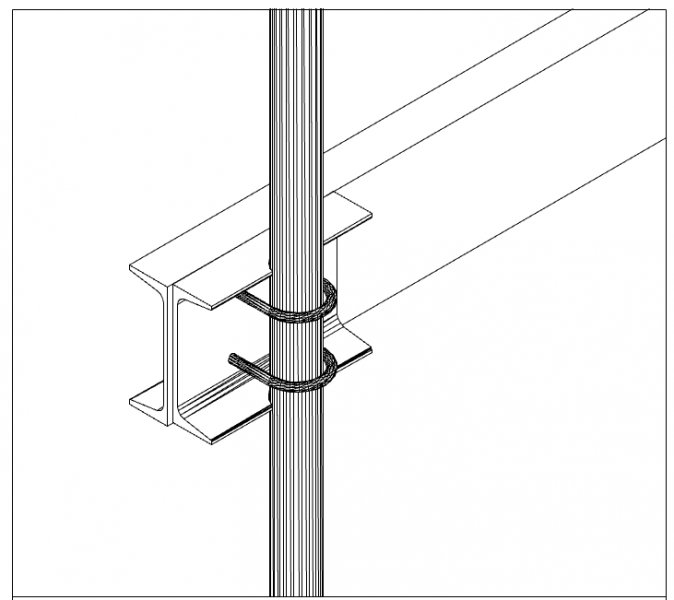

The way I started out yesterday afternoon was terrible - looked like crayons...
Since I'm into this so far already.....
I went back to try it.
Does the software on this site automatically delete expletives? :twisted:
I don't know how I got a solution - again - Thanks for the help.
I can at least make something relatively presentable.

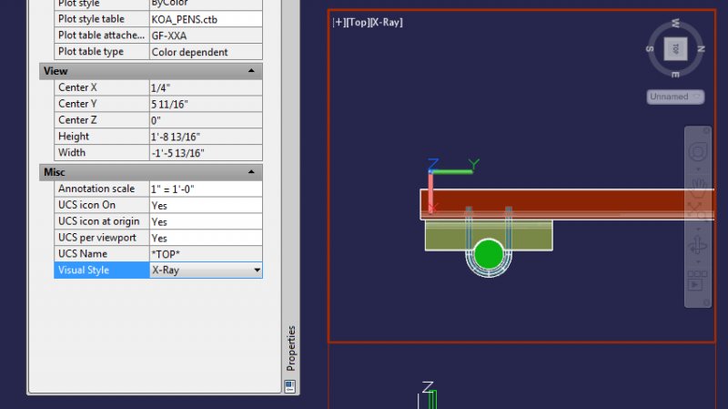

The pallet doesn't look like it will allow me to change the visual style.
The square with X-Ray in it is gray like it can't be changed.
It can.
I am.
2D wireframe with crisp lines will work.
