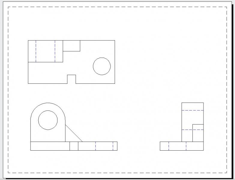

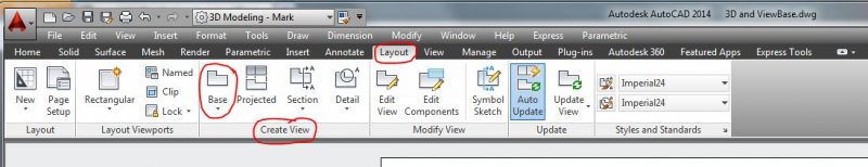

ReMark Posted February 27, 2014 Posted February 27, 2014 AutoCAD 2014. Use the BASEVIEW command. It will create 2D views from your 3D model in your layout. In your 3D modelling workspace click on the Layout tab then look at the Create View panel. Quote
ReMark Posted February 27, 2014 Posted February 27, 2014 Quick example using BASEVIEW. You can also create sectional and isometric views as well. Quote

ReMark Posted February 27, 2014 Posted February 27, 2014 At the command line it is VIEWBASE. I don't know why AutoDesk set it up that way. You are better off using the Ribbon. And you should be in a layout when you do. Quote
Dinochrome Posted February 27, 2014 Author Posted February 27, 2014 OK - I have a 3D view with the BASEVIEW command from the ribbon (can't type that in...) The view is showing my whole assembly. I'd like to clip it down, right click gets me to a rudimentary edit with scale and edge visibility only - and a check/cancel box like Revit. properties pallet shows nothing... ? Quote
ReMark Posted February 27, 2014 Posted February 27, 2014 I think you missed one of my posts re: what to type at the command line. "Clip it down"? You mean a sectional view or are you looking for something equivalent to a "clipping plane"? Quote
Dinochrome Posted February 27, 2014 Author Posted February 27, 2014 OK, I used the detail button 3 to the right of the BASE button you have circled in red. I think this is going to work. Quote

ReMark Posted February 27, 2014 Posted February 27, 2014 No equivalent clipping plane. If you have three objects but only need 2D views of one of them you are allowed to specify the particular object. By the way, in 2014 there is a "detail" view option as well. Details can be circular or rectangular. Maybe that will suffice? Unless we know more about what you are doing (and drawing) it would be difficult to answer your other questions. Quote
Dinochrome Posted February 27, 2014 Author Posted February 27, 2014 temp2.pdf I got something now. I used the Base command to make a 3D looking (view?) I used the "Detail" command three over to the right of the "Base" command you have circled. Apparently I had to have the first view to select in which to make the second "Detail" view. Parts of this resemble Revit in my estimation. BASEVIEW on the left. Regular 3D viewport on the right. Something changed though. Now my 3D viewport is plotting nicely. I have no idea what changed. Quote
