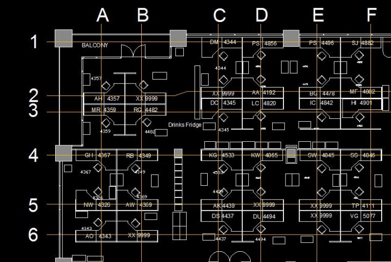

I maintain our office floorplans with employee names in AutoCAD. With 33 buildings and about 125 different CAD files, it can get cumbersome if there are a lot of changes to be made.
I want to create a way to make this process easier. I'm thinking if I have some sort of block that can export all employee names and related location numbers to an excel spreadsheet/database, I can easily just edit the excel file without opening the CAD files.
Is this possible. Can anyone point me in the right direction? ;)
I did something similar "where do they sit" I used the phone number as the link and compared it to our phone list. I took the office plan added the phone number twice two layers the second is used to reference a picture of the staff member which is inserted into the floor plan. The second part is a reference grid this was added to the phone list location & grid A 5. Its not automatic as I have to manually edit the excel to add a update routine was a lot of work.

Just had a crash attempt 2 using a staff members phnum as link its twice as one is for display the other is for where their image will appear. It uses the phone list say in excel as a cross reference but the excel is manulay edited but with some help via the second lisp, using sort to match phnum and location.

You can also try using ATTOUT to export to spreadsheet. Then after editing, update the attributes in AutoCAD using ATTIN.
