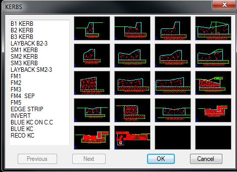

BIGAL Posted February 19, 2014 Posted February 19, 2014 2nd go down the tool palette path or a menu or old fashioned like me. Quote
