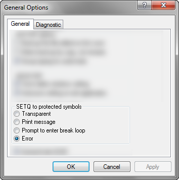

when i tried:
(setq T "true")
i got warning that say:
assignment to protected symbol
T
Enter break loop?
if i press yes, T is still protected, if no, T is redifined
what is this break loop?
Thanks
Shay
Edited by samifox
What is this break loop?
That behaviour is controlled by the following setting in the Visual LISP IDE, located under Tools > Environment Options > General Options:
Though, it is not recommend to redefine protected symbols, since AutoLISP programs supplied with AutoCAD (such as the Express Tools programs) will be dependent on these protected symbols holding particular values.
