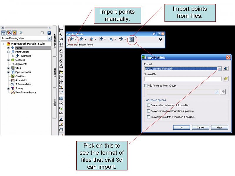

Is your data importable or just on paper?
If your data is on a paper, you can input them to civil 3d manually. You can also import data from a file that is a .csv or .txt format. But since you only have 5 points and 1 BM, i suggest you input them manually. You might want to encode the points and import it.
Draw lines representing the ray direction ie angle with horizontal distance you can then use modify to edit the end point to the correct height, add Autocad points to the ends view in 3d vpoint 1,1,1 should look ok for school.
