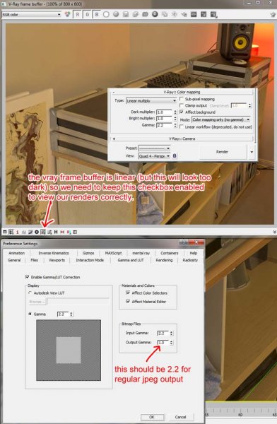

uzixs911 Posted February 12, 2014 Posted February 12, 2014 hi every one i have a problem.. i use vray for rendering . now when i see the render preview then the quality is fine but when i save the render image it appears bright to much bright . i googled it and played with the gamma values in vray and also in vray renderer setup. some how got the problem solve but still lacking quality. now my main question is my render image appears good but jpg apperas bright . Quote

spittle Posted February 14, 2014 Posted February 14, 2014 It's likely that you're adding gamma to your output image twice. If you post your gamma settings from your preferences, as well as settings from the Vray colour mapping tab in the render options then you'd probably get more replies as there are a few variables. In the frame buffer it's good to have the little sRGB button enabled always - this doesn't affect your saved image. Consider it like wearing a pair of sunglasses and just for viewing in Max, when disabled you are viewing a linear image. In colour mapping tab, set the 'mode' to 'Colour mapping only' Now your output gamma will be determined by your preferences. Which you probably want to set to 2.2. Quote
uzixs911 Posted February 17, 2014 Author Posted February 17, 2014 ok i will check it i adjuseted my gamma value to 0.85 and when i save i change it to 1.05 so i see the same image in rendering mode and in jpeeg mode Quote
spittle Posted February 18, 2014 Posted February 18, 2014 Need your render settings mate. Gamma settings in Preferences and vray colour mapping tab. Quote

uzixs911 Posted March 10, 2014 Author Posted March 10, 2014 these are my screen shots . as requested mate . please see the settings and tell me Quote
spittle Posted April 4, 2014 Posted April 4, 2014 Just back from holiday - the settings in the attached image work correctly. Quote
