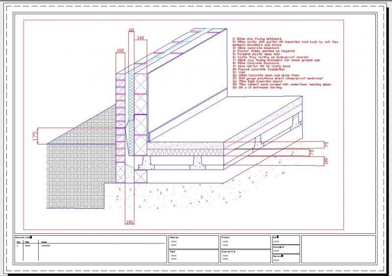

It took some measure of effort to reproduce your drawing as seen in the image below. The magenta rectangle you see is your viewport through which can be viewed your model space objects. The notes in the upper right hand corner are actually in the layout and not over in model space. The viewport scale has been set to 1:10 and the viewport display has been locked so the scale would not be inadvertently changed if one were to choose to work through the viewport in model space. This means you can't zoom and pan however inside the viewport without first unlocking it.
Both the template and the isometric foundation drawing you provided are in need of some serious reworking as there are a number of things that aren't quite right. If you have any questions please ask.

stampan76, that template file was a bit of a mess, objects floating out way away from the border, the border was made with splines instead of plines or lines, etc.
Normally you would start a file from a template that has a border in it, but since you didn't do that I saved the template file as a .dwg file. Then in the detail drawing I went to the layout and inserted the border drawing. Then created a viewport (MVIEW) and adjusted the scale to 1:20 just to show it without it taking up the whole drawing. Not sure what scale you would need.
