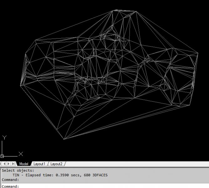

Costinbos77 Posted February 9, 2014 Author Posted February 9, 2014 Congratulations, you did a great job! That I wanted to do. Goes well. Try this set of data and see where it messes up: Puncte 3D.dwg I think it should restrict somehow not form the outer triangles. Quote
ymg3 Posted February 9, 2014 Posted February 9, 2014 Costinbos, It does not mess up, what tou have is a Delaunay Triangulation. Now if you want a Constrained Delaunay Triangulation (CDT), it does not do it currently. Same with Breaklines, working on it albeit slowly. ymg Quote

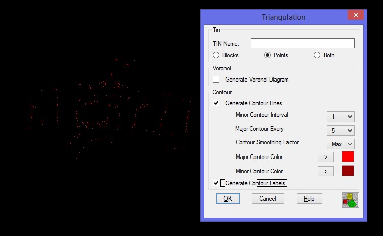

ymg3 Posted February 9, 2014 Posted February 9, 2014 Costimbos, There seems to be a problem I will investigate. Here goes with an interval of 0.2 meters. ymg Puncte 3D.dwg Quote
Costinbos77 Posted February 9, 2014 Author Posted February 9, 2014 I just mentioned to you can fix it. Again, you did a great job. Maybe you should separate the level curves of the creating TIN. The TIN to be created and for calculation of volumes and sections (profiles). But about #9? Quote

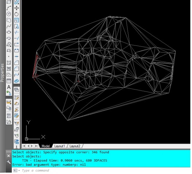

bullah Posted December 2, 2014 Posted December 2, 2014 many thanks Costinbos77 Command: tin Select objects: Specify opposite corner: 30 found Select objects: TIN - Elapsed time: 0.1720 secs, 47 3DFACES Command: cont Select 3DFACES Select objects: Specify opposite corner: 47 found Select objects: Error: bad argument type: numberp: nil why i cannot make contour?? sorry bad english Quote

Costinbos77 Posted December 2, 2014 Author Posted December 2, 2014 (edited) Many thanks for ymg3 that He has made available his work. For contours sometimes give error. You must choose a different spacing. Ask ymg3 for the latest version. Edited December 3, 2014 by Costinbos77 Quote
