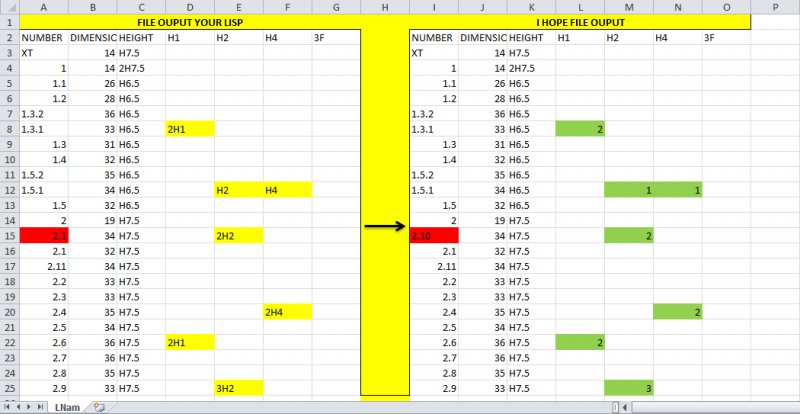

minhphuong_humg Posted February 9, 2014 Author Share Posted February 9, 2014 Although that the first code worked in my system but try the modified codes above and let me know . CODES UPDATED ABOVE Thank Tharwat very much. I have a few opinion: 1-File output result splitted to other column. However, value in column Ạ is missing number 0 if value is 2.10 =2.1, 16.10-->16.1, 125.10--->125.1. Summary is missing number 0 after the comma. 2-In column (D (H1)| E (H2)| F (H4)| G (3F)) value in the column is number (1, 2, 3.....) don't get value (H1, H2, H3, 3F...). The value of the column is taken get in front of number of H1, H2, H4, 3F (ex: H1 = 1H1--->get value 1; 2H1--->get value 2; H4= get value 1; 3-3F-->get value 3; 3F--->get value 1;.....) P/S: Case 2 (ex: cell A1 (in Excel) = H1) the same function: if(A1="H1",1,left(A1,1) in Excel. I don't know how AutoLISP performances. Please, Tharwat help me! Thank Tharwat very much. Quote Link to comment Share on other sites More sharing options...

minhphuong_humg Posted February 10, 2014 Author Share Posted February 10, 2014 Everything goes very well here , you may need to try it on another machine or we may wait for any of the users here to try it and let us know . Dir, Tharwat. I think Tharwat don't understand my opinion . Please, view picture to difference 2 result. Please, help me. Thank Tharwat very much. Quote Link to comment Share on other sites More sharing options...
Tharwat Posted February 10, 2014 Share Posted February 10, 2014 I think Tharwat don't understand my opinion . I will consider this phrase as the English language is not your native one , so I would ignore it . Back to theme , Select the whole column A by pressing on the first cell in Excel then right click -> general -> number then increase the decimal numbers as much as you want . Quote Link to comment Share on other sites More sharing options...
minhphuong_humg Posted February 10, 2014 Author Share Posted February 10, 2014 I will consider this phrase as the English language is not your native one , so I would ignore it . Back to theme , Select the whole column A by pressing on the first cell in Excel then right click -> general -> number then increase the decimal numbers as much as you want . Yes, . I'm Vietnamese. I understan the language is hurdle of us. Please, help me Case 2 is get value in column H1, H2, H4, 3-3F. Thank you very much! So You please view image. Thank you very much. Quote Link to comment Share on other sites More sharing options...
