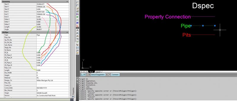

Ssewell Posted February 7, 2014 Posted February 7, 2014 Hi all, Need to get this sorted as soon as possible. It is beyond me im afraid . I use AutoCAD Map 2013 - attached is a sample dwg and a picture of what i require. Each line represents where the data needs to go. Also explained here: Basically i have object data attached to a 3d line for a drainage pipe. In the properties-Geometry of Autocad it has the Start X, Start Y, Start Z, End X. End Y,End Z of the line and all i require is each to automatically fill out my Object Data table - OD:Pipe Start X = DS_Pipe_E Start Y = DS_Pipe_N Start Z = DS_IL End X = US_Pipe_E End Y = US_Pipe_N End Z = US_IL And then i just need the Length of the line to fill out the Length in the Object Data Table. Once i understand the concept i will need to do the same for the property connections and then pits. but am happy to try get one solved first. This will literally save me hours every week and it has to be possible. Any help will be so greatfully appreciated. Drainage.dwgFetching info... Quote

Ssewell Posted February 9, 2014 Author Posted February 9, 2014 Emigrato said: No way, I'm sorry.The START/END geometric fields are automatically fed up by the display list, so you cannot 'em edit. You'd better add those custom 6 start/end as Object Data, sir. I have no idea what you just said? i dont want to edit them i jsut want to copy paste them - which can be done physically i just want to automate it. Quote
Ssewell Posted February 9, 2014 Author Posted February 9, 2014 Murph_map said: You can do it with a custom lisp routine or export to sdf format then data connect to it and run a number of calculations then import back into map and create OD tables. If you just need a table showing the data you can try dataextract, why does it need to be object data? Yea i gathered i would need a lisp routine. i just dont know how to extract the correct data - and then get it back into the object data. how do i extract the co-ords to a spreadsheet and then import them back? help? it needs to be the object data so then for that pipe all the information can be exported together - linked to the object for input into a GIS system. as Big Al said below - its for a Dspec submission. so it needs to be in the object data. Quote

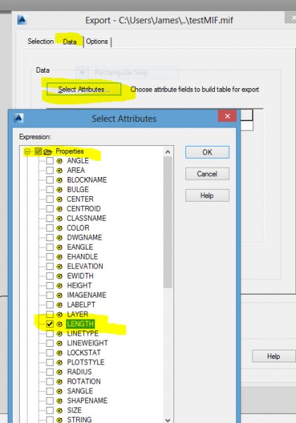

Murph_map Posted February 11, 2014 Posted February 11, 2014 When you export to MID/MIF you can create the attributes from the properties of the lines. No need to create the Object Data unless you want to keep it as dwg. See attached. Quote
Ssewell Posted February 11, 2014 Author Posted February 11, 2014 Ok cool, that's awesome. I didn't realise there was more options and that you could rename the outputs! i think that has basically solved my problem i just need to set them all up and save a template! I see that i can use X1,Y1 and Z1 , X2,Y2 and Z2 as well. thank you so much for your help Murph! I appreciate it. i havent tested it yet but if i export this then when i do the reverse and import it - fingers crossed it will work. ill test it when i get a chance today. Cheers Again! Quote
