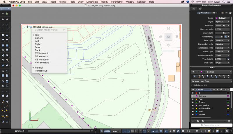

Tiger Posted February 6, 2014 Share Posted February 6, 2014 Ok, I inserted the drawing as an exploded block in another file, then I can Zoom and Pan as normal... tried all the tricks I know; Recover, Save to Dxf, Save to old DXF/DWG, purge, -purge, audit.... but Insert as block worked. Just realised that I removed all the blocks in the drawing before I inserted it as a block, so that could change things. Quote Link to comment Share on other sites More sharing options...
AdrianR Posted February 6, 2014 Author Share Posted February 6, 2014 I tried copybase and pasting this drawing and another drawing that was doing the same thing into a new drawing and I could zoom in then. So I guess I could do that whenever this happens, it's just a pain to have to do. I was hoping there was a limits setting or something else I had wrong that would fix this. Thanks all! Quote Link to comment Share on other sites More sharing options...
Incadnito Posted February 9, 2014 Share Posted February 9, 2014 Hey.. Had this problem myself a couple of times My fix/hack is to activate viewcube and press "top" Downloaded your file and couldn't scrollzoom aswell. Did the above - and voila - no prob Quote Link to comment Share on other sites More sharing options...
Dadgad Posted February 9, 2014 Share Posted February 9, 2014 Hey.. Had this problem myself a couple of times My fix/hack is to activate viewcube and press "top" Downloaded your file and couldn't scrollzoom aswell. Did the above - and voila - no prob Right you are Incadnito, I was having about as much luck as everbody else, until I tried your fix, and all of a sudden, no problem! While the issue is odd and annoying, this fix is pretty painless, good call. It seems like the ZOOM to extents after view change option in the View Cube settings is resolving whatever the hang up is with the terminal Zoom issue. Quote Link to comment Share on other sites More sharing options...
AdrianR Posted February 10, 2014 Author Share Posted February 10, 2014 Thank you x 1000000!! I tried this in a few drawings and it works!! Quote Link to comment Share on other sites More sharing options...
gwhibley684 Posted March 20, 2017 Share Posted March 20, 2017 Hi there I have been having similar problems with not being able to zoom in as far as I want and I have just discovered what the issue was. now I have no problems. I had my view type on perspective rather than parallel. near the top left of your viewport, click on the view next to the + and change to parallel and you should have no more problems. Hope that helps!! Quote Link to comment Share on other sites More sharing options...
