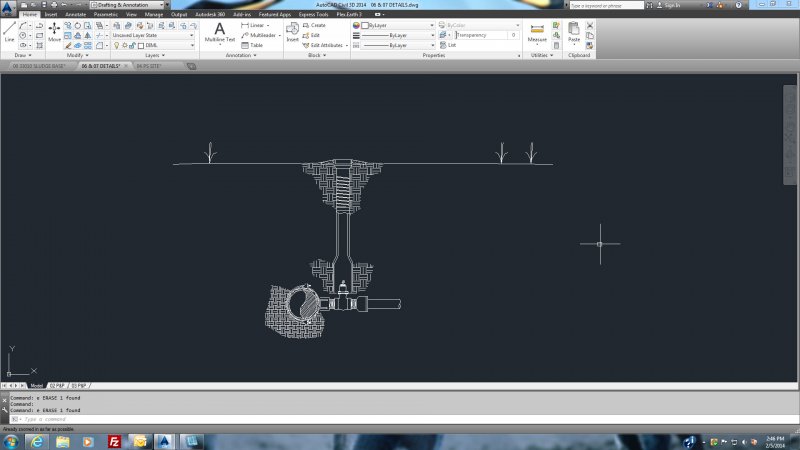

AdrianR Posted February 5, 2014 Posted February 5, 2014 I have many drawings where I try to zoom all the way into edit and it won't let me. I use the wheel to zoom. In the bottom left says "already zoomed in as far as possible". Is there a setting I can change or something I can do to be able to zoom it more? I am using AutoCAD Civil 3d 2014. Thank you! Quote

AdrianR Posted February 5, 2014 Author Posted February 5, 2014 I don't think that's it. This is as close as I can get. Quote

AdrianR Posted February 5, 2014 Author Posted February 5, 2014 Not on every drawing, only some. And I just upgraded to 2014 and it was doing it before. Attached is the drawing. Thanks! ZOOM.dwg Quote
Dana W Posted February 5, 2014 Posted February 5, 2014 Nope, that's definitely not the perception error I was referring to. Here's a wild idea. Has somebody left recently with a bad attitude. Maybe somebody that would have scaled down the drawings by some ridiculous factor like .00000001 to get even for something? I just tested this and one can scale down beyond the zoom in limits. Quote
rkent Posted February 5, 2014 Posted February 5, 2014 I copy and pasted the detail into another file and I could zoom as expected. Something in that file and probably has to do with the Civil program and or Geo references, etc. Quote
Dana W Posted February 5, 2014 Posted February 5, 2014 OK, that is weird. I can't zoom or pan. Well, I could when I first opened the drawing (converted by TrueView to 2007) but it stopped. What's more, I could not even get the cursor too come out of the drawing area back to the CUI. The cursor WILL NOT cross the edge of the drawing area, but I can get it to show me coordinates from beyond the workspace frame. It is as though the display screen is bigger than the AutoCad window. I had to type QUIT to get out of the danged thing. I am baffled so far. Quote
Dana W Posted February 6, 2014 Posted February 6, 2014 It is acting as if there is a viewport in modelspace, the viewport is active, maximized, and has Display Locked turned on. Quote
Tuns Posted February 6, 2014 Posted February 6, 2014 This is so weird. I took off all of the georeferences and I still can't move the view anywhere. I tried purging it and I can't even remove the layers you aren't using. Is this drawing possessed? Quote
