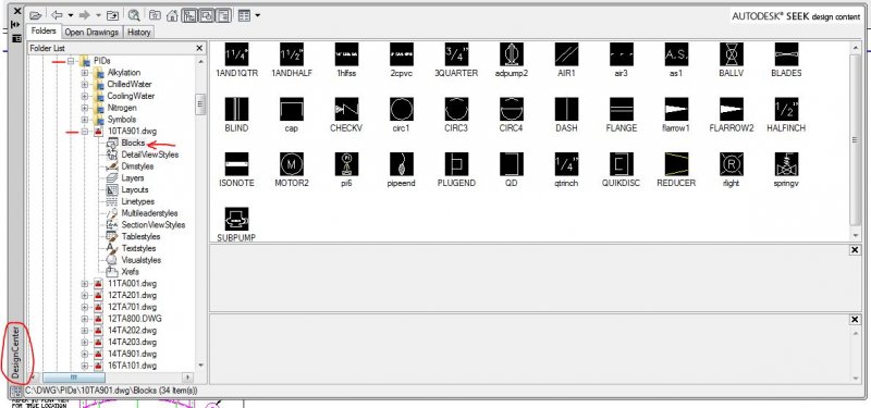

darrellk-1 Posted February 4, 2014 Author Posted February 4, 2014 Wait, I just remembered that I saved this as a Write block so I could access it for use in other drawings. If I save it as a Block, it is only good for that one drawing, correct? How would I access it if I were not in the drawing where it was created? Quote
ReMark Posted February 4, 2014 Posted February 4, 2014 You can access your dynamic block that is in one drawing while you are in a second drawing via the Design Center. It is just a matter of dragging and dropping the block into your drawing. Have you ever used the Design Center? Yes, you should have used WBlock if your intent was to create a block that could easily be inserted into other drawings or like I said, create a custom tool palette and put your dynamic block on that. Quote
ReMark Posted February 4, 2014 Posted February 4, 2014 The Design Center in action. In this example I have opened a piping diagram and asked to see the blocks contained within the drawing which appear on the right. Quote
