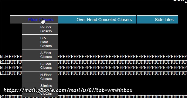

vpatterson Posted February 3, 2014 Posted February 3, 2014 I need to center my text and my drop down menu, using CSS and I cannot figure it out. I have tried multiple thing and nothing is working! here is my CSS code: #menu:after {clear:both;} ul { font-family: Arial, Verdana; font-size: 14px; margin: 0; padding-bottom: 60px; list-style: none; } ul li { display: block; position: relative; float: left; } li ul { display: none; } ul li a { display: block; text-decoration: none; color: #ffffff; border-top: 1px solid #ffffff; padding: 5px 15px 5px 60px; background: #1e7c9a; margin-left: 1px; } ul li a:hover { background: #3b3b3b; } li:hover ul { display: block; position: absolute; } li:hover li { float: none; font-size: 11px; } li:hover a { background: #3b3b3b; } li:hover li a:hover { background: #1e7c9a; } And my drop down menu code: Floor Closers P-Floor Closers BP-Floor Closers A-Floor Closers F-Floor Closers H-Floor Closers Slimline-Floor Closers Over Head Conceled Closers P-Over Head Conceled Closers BP-Over Head Conceled Closers A-Over Head Conceled Closers F-Over Head Conceled Closers H-Over Head Conceled Closers Side Lites Can someone please help me? photo attached as well. Quote
vpatterson Posted February 3, 2014 Author Posted February 3, 2014 The closest to center I can get is by changing the padding but it is not truly center. My new code is: .center { margin-left:36.5%; margin-right:50%; width:30%; background-color:#b0e0e6; text-align: center; vertical-align: middle; } ul { padding:0; margin:0; list-style: none; background:#000; height:36px; text-align:center } ul li { float:left; position:relative; } a:link, a:visited { text-decoration: none; color: #FFF; font-weight:bold; } ul li a, ul li a:visited { display:block; color:#fff; width:auto; height:auto; line-height:20px; padding:10px; text-align:center; } ul li a:hover { display:block; color:#000; background:#FFF; line-height:20px; padding:10px; } ul li ul, ul li:hover ul li ul { display: none; } ul li:hover ul { display:block; position:absolute; top:auto; left:0; height:auto; } ul li:hover ul li a { display:block; text-align:center; border-bottom:1px solid #FFF; } ul li:hover ul li:hover ul { display:block; position:absolute; left:124px; top:0; } Navigation code is : Floor Closers P-Floor Closers BP-Floor Closers A-Floor Closers F-Floor Closers H-Floor Closers Slimline-Floor Closers Over Head Conceled Closers P-Over Head Conceled Closers BP-Over Head Conceled Closers A-Over Head Conceled Closers F-Over Head Conceled Closers H-Over Head Conceled Closers Side Lites I need the navigation bar to be truly centered... Please HELP? Quote
steven-g Posted February 4, 2014 Posted February 4, 2014 Which browser are you using, because in IE9 it looks pretty good, Chrome is another matter, I'll take a look later. In the meantime could you go back to your posts and wrap the code in code tags - it does make copying the text much easier. Quote

steven-g Posted February 4, 2014 Posted February 4, 2014 My new code is:.center { margin-left:36.5%; margin-right:50%; width:30%; background-color:#b0e0e6; text-align: center; vertical-align: middle; } Try swapping out the first 3 lines for a float .center { float: left; background-color:#b0e0e6; text-align: center; vertical-align: middle; } And the wrapping code means doing as I did above, use the "#" symbol when you are writing your post. It just makes things easier to read and use. Quote

steven-g Posted February 5, 2014 Posted February 5, 2014 It works fine here (which I know doesn't help you), if the computer is that old it is probably the browser that doesn't support certain parts of your code. I have attached my files just in case I did change anything else without remembering, but you might have to either try and update to a newer browser, or search for older versions of the things you are trying to do. index-html.txt style-css.txt Quote
