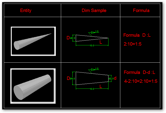

Thank you vimcruz ,I don't know Where need to use "angle" "percent" "everything", I think Only need two buttons, "slope" and "taper"

Lucas3, for the "taper" function I need more than the formula, I'm trying to understand how it works on real field to do it right. I've been searching for "taper" in google without luck. Need to know if there's something more than just the ratio (1:N).
Regards

vimcruz ,Thanks for your efforts, about taper at #17
slope formula = tgα= H / L
taper formula= 2 tgα=(D-d)/ L
Tangent function
I just query the data, Autocad mechanical dim methods:1. choose datum line ,2.choose line of reference
Dimension taper method is more interesting: Must first draw the center line (command:amceninbet),Centerline as the datum line
BTW, use Autocad mechanical ,Can specify the starting point of the lead
