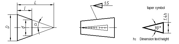

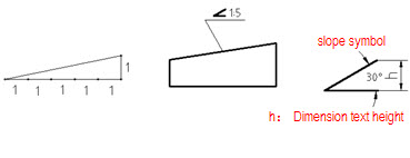

lucas3 Posted February 3, 2014 Posted February 3, 2014 Hi,guys How to dim slope and taper? like this: Find forums, did not find anything! Thanks for any help! Quote
lucas3 Posted February 6, 2014 Author Posted February 6, 2014 highflybird said: this?[ATTACH=CONFIG]46660[/ATTACH] YES!highflybird,Can you post code?thank you very much! Quote

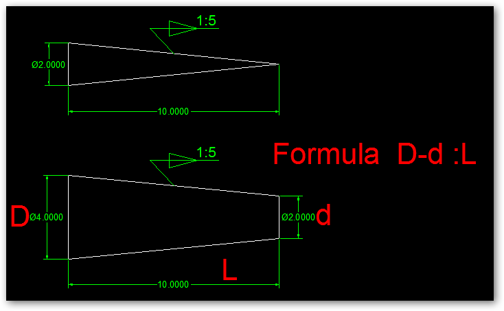

lucas3 Posted February 13, 2014 Author Posted February 13, 2014 Thank you MSasu ! Vimcruz,how to dim taper ? Quote
