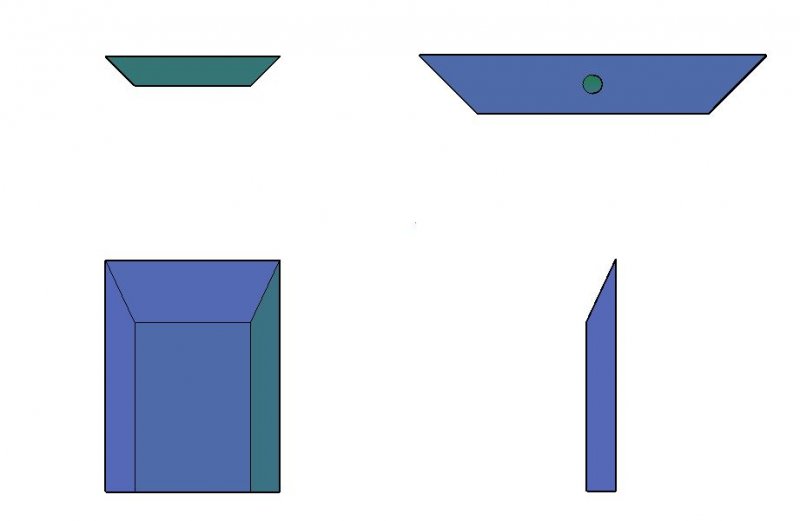

ReMark Posted January 31, 2014 Posted January 31, 2014 Since your attached image had no dimensions I used my imagination to create this example. The views by corner are... Top left = Top Bottom left = Front Bottom right = Side Top right = Bottom Three of the view use the same scale. The view showing the bottom is at a larger scale so you can see the hole I made. All four views were done using the Conceptual visual style. The object is a 3D solid. I'll post an image showing a 2Dwireframe in isometric view shortly. Quote
ReMark Posted January 31, 2014 Posted January 31, 2014 From your attached image it appeared as though the hole in the bottom was at an angle. I don't know if that was your intent or not. It doesn't really matter though as creating the hole is quite easy, just a matter of subtracting a cylinder made by extruding a circle. Until we get more definitive information this example will have to suffice. Quote

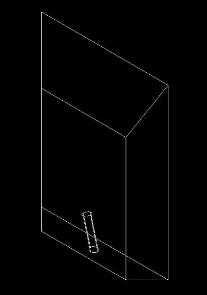

rdjavi Posted January 31, 2014 Author Posted January 31, 2014 ReMark, thanks for help! On image below to better see the shape of the object. http://imageshack.com/a/img854/2853/zfs4.jpg I solved the problem using the Loft comand, and a hole I drew using the Subtract option. I am interested in how you drew a 3d solid? Quote
ReMark Posted January 31, 2014 Posted January 31, 2014 I drew the base profile and extruded it upwards then used Taper Faces to achieve the slanted top. Quote
